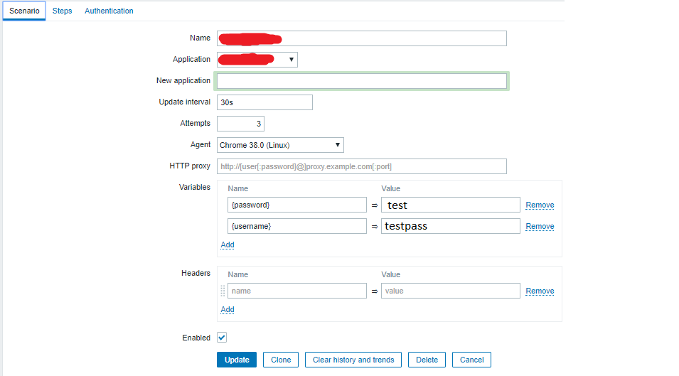

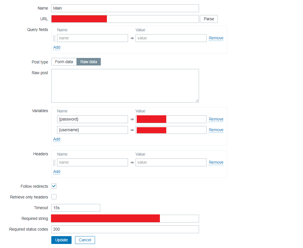

      androponia , I've used one word to find, I clicked on web page "Inspect" and then found word which I need. It's looks like:
      Below screenshots of my configuration:
      In the Required string I've tried to find, for example word "[OK]", so I've inputted: <a href="http://google.com/"><span style="color: red">[OK]</span></a>

        It seems that you define variables instead of POST variables, when you try to log in to a page you must pass or query fields, or POST variables.
        like: the image below:

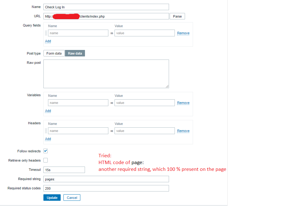

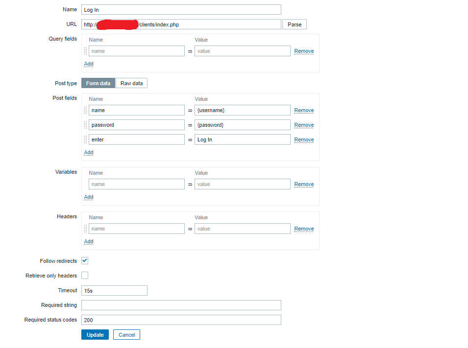

          I've updated my scenario. Now it has 4 steps, as here https://www.zabbix.com/documentation...toring/example
          So, I have:
          -Log In (and it seems okay)
          -Check Log In(Here is problem)
          -Log out
          -Check Log out

          Log In
          Check Log In:

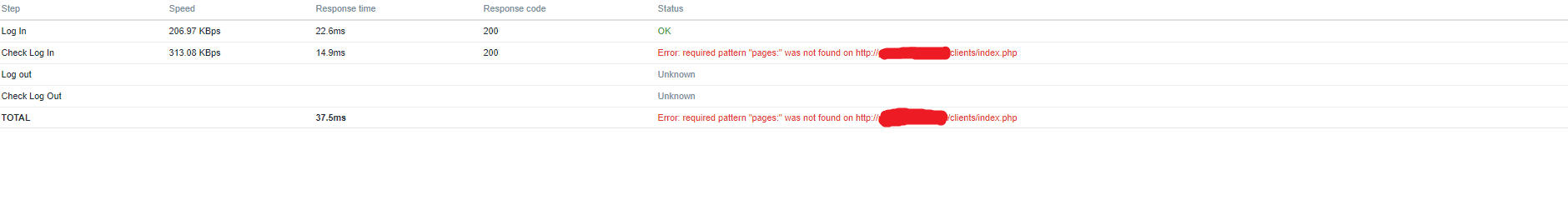

          Output always the same:

            Done it. My fault was in Authentication
