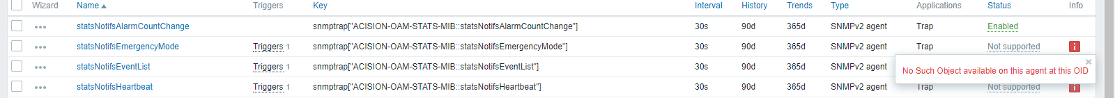

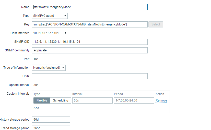

                        I have placed the correct file and the reported problem got sorted out . After that again I am getting below error. Could you please help me on this
                        After uploading the mibs to the path I have added a trap item with OID and after saving it is giving me an error as below (Both the screenshots are attached). Could you please look into this and help me in fixing this.plz.....

                          And what happens when you are trying to get data using snmpget/snmpwalk command?
                          • vnoc
                            • Sep 2017
                            • 115
                            Its just giving error I have not done any snmpget/snmpwalk command.
                            If it is compulsory to perform those commands . kindly let me know where should I perform that
