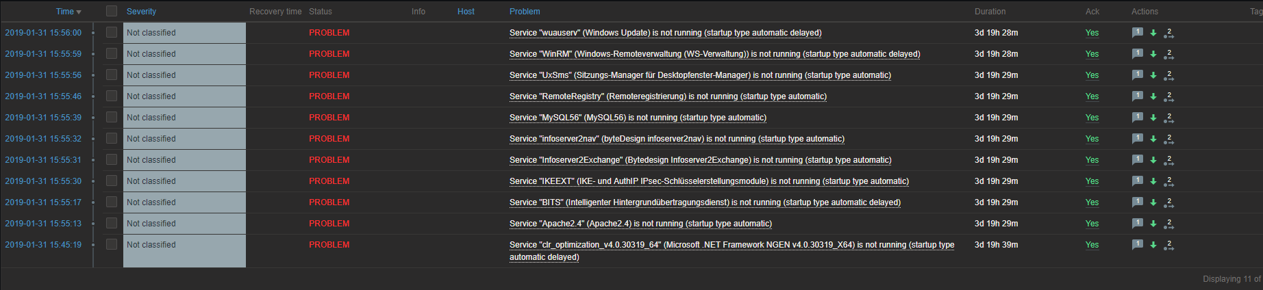

    Since a few days, I'm trying to remove some orphaned or broken data in Zabbix. I added a Template about Systemd Service Discovery on Linux.
    I then added these template to a few hosts, and it's working. But then I realized that one host where added with the wrong IP, so I changed the IP in the config of the host, and deleted the discovered items. But a few of these items already alerted a Problem.
    The Problem is now staying open.

    I even deleted the whole host, removed the template from the host etc. but the Problems still stay open, with no Host...

    I had still no luck in deleting these entries. Does nobody know how to delete these data?
    These entries suck, I want to see actual problems, not ghosts.

    But this doesn't help either. A Select statement doesn't even pick up the triggers in the first screenshot.
    MariaDB [zabbix]> select * from triggers where error LIKE '%wuauserv%';
    Empty set (0.009 sec)
    See the first entry of the screenshot.

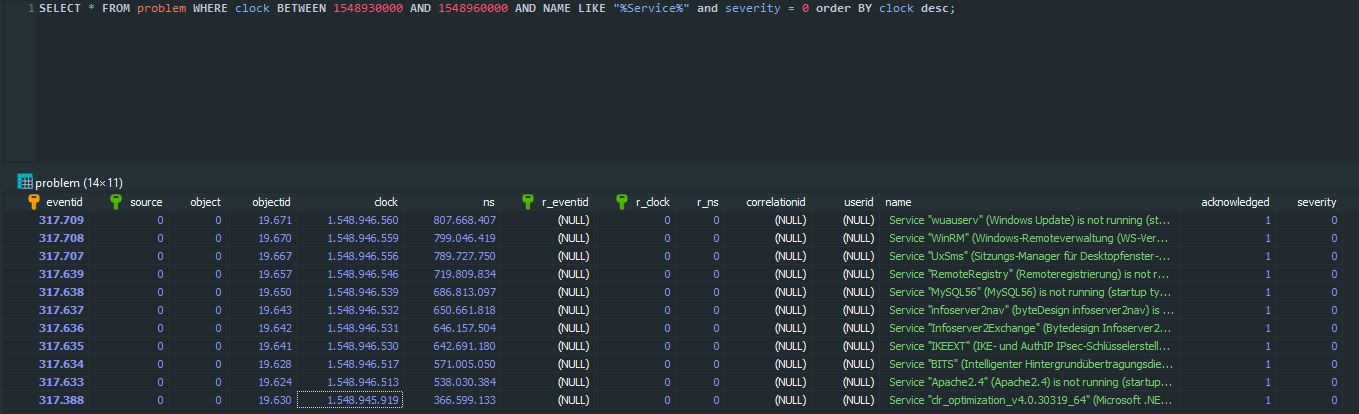

      I finally was able to delete the Problems out of the database.
      Here is how:
      I searched for the correct table where the problems are stored. then I selected a time (clock) between the first and the last problem I need to delete, and defined the first word of all problems so no other data in these time will be deleted, then I changed the severity of all "to delete" data in Zabbix to "not classified" in DB it will be severity= 0 and in the end I sorted the output by clock descending.
      After I got the exact output of that 11 entries that I needed to delete, I just deleted this 11 entries by eventid.
Name:	2019-02-06 10_25_21-IDS23_zabbix_zabbix_problem_ - HeidiSQL 10.1.0.5471.png
Name:	2019-02-06 10_27_56-IDS23_zabbix_zabbix_problem_ - HeidiSQL 10.1.0.5471.png
      SELECT * FROM problem WHERE clock BETWEEN 1548930000 AND 1548960000 AND NAME LIKE "%Service%" and severity = 0 order BY clock desc;
      /* Betroffene Zeilen: 0  Gefundene Zeilen: 11  Warnungen: 0  Dauer von 1 Abfrage: 0,016 Sek. */
      SHOW CREATE TABLE `zabbix`.`problem`;
      DELETE FROM `zabbix`.`problem` WHERE  `eventid`=317709;
