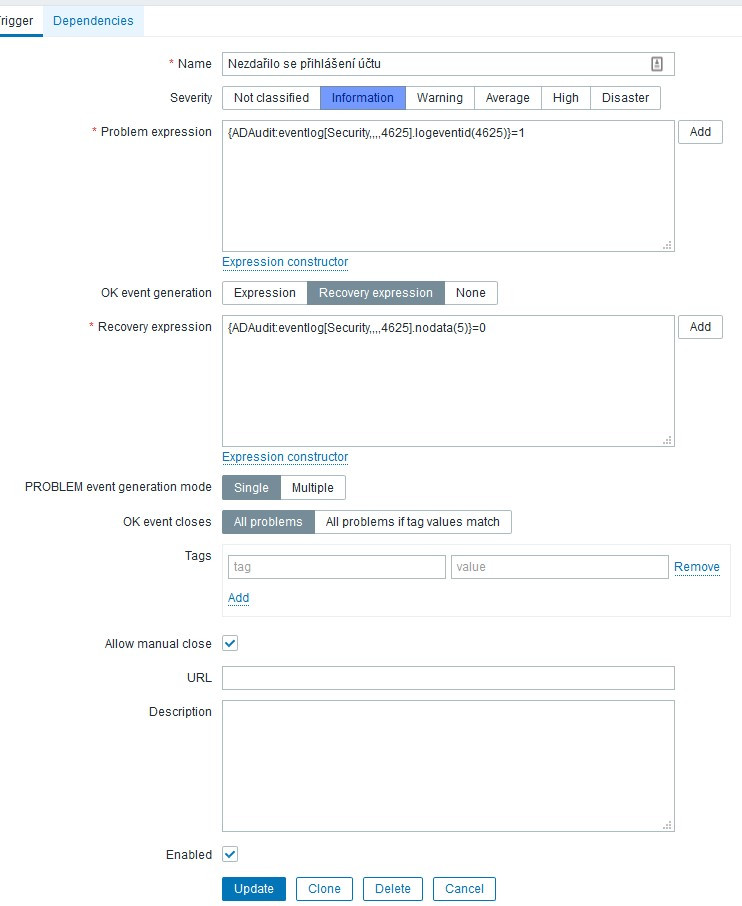

    I have a problem with the fact that the trigger recovery does not work on Zabbix 4.0.4. I downloaded ADAudit tamplate - https://share.zabbix.com/operating-s...security-audit
    Everything works (eventlog reads from Windows Server 2012 R2), but triggering the error will not resolve the trigger.
    I can not find a bug anywhere. Someone is wrong with me.
    This thread should work, but unfortunately it is not.
    https://www.zabbix.com/forum/zabbix-...ger-recovering
    Trigger Setting:
    Problem Expression:
    {ADAudit:eventlog[Security,,,,4625].logeventid(4625)}=1
    Recovery Expression:
    {ADAudit:eventlog[Security,,,,4625].nodata(5)}=0
    Will anyone advise me where I'm making a mistake?
