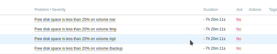

      • Andrzej PAwlik
        • Feb 2019
        • 27
        I have the same problem after upgrade Zabbix 3.2 to 4.0
        In my case help
        1. fix time on the server.
        2. restart agent zabbix.

        • kloczek
          • Jun 2006
          • 1771
          In my case help
          You need to have everywhere as RTC (Real Time clock) as UTC time. Check what shows you "date -u" command.
          You can have on every system different time zone but UTC it is on top of UTC.
          Looks like you are setting up on those system as RTC not UTC but exact zone times by this you have all those observed time shifts.
          Your issue has nothing to do with zabbix. Simple you are setting up incorrectly time on your systems
