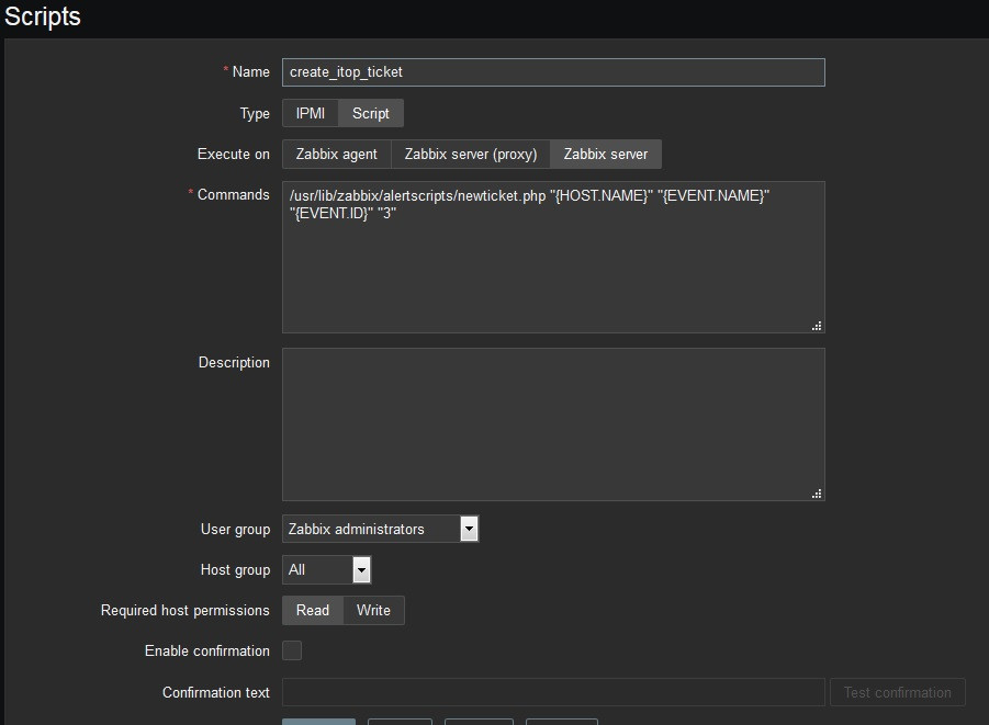

    Script configuration is as follows:
    /usr/lib/zabbix/alertscripts/newticket.php "{HOST.NAME}" "{EVENT.NAME}" "{EVENT.ID}" "3"

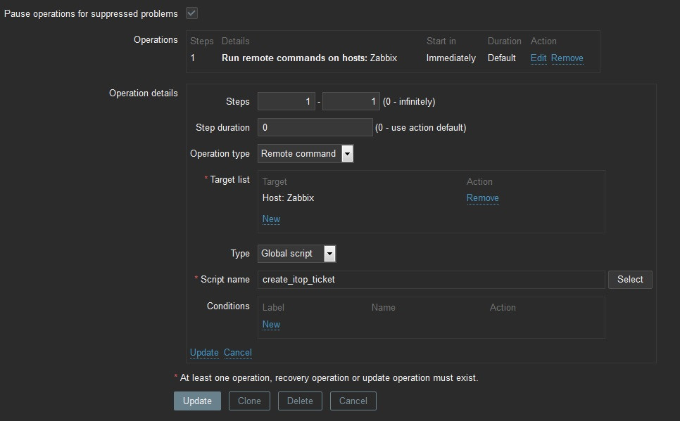

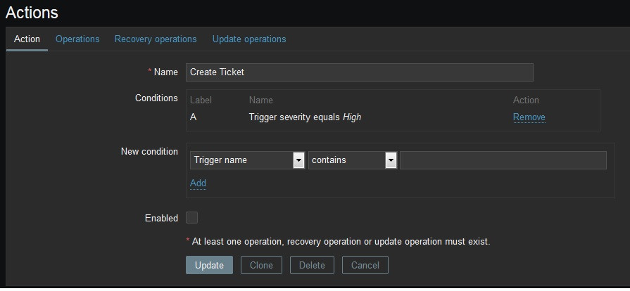

    Action defined to run the PHP script whenever a HIGH ticket is encountered

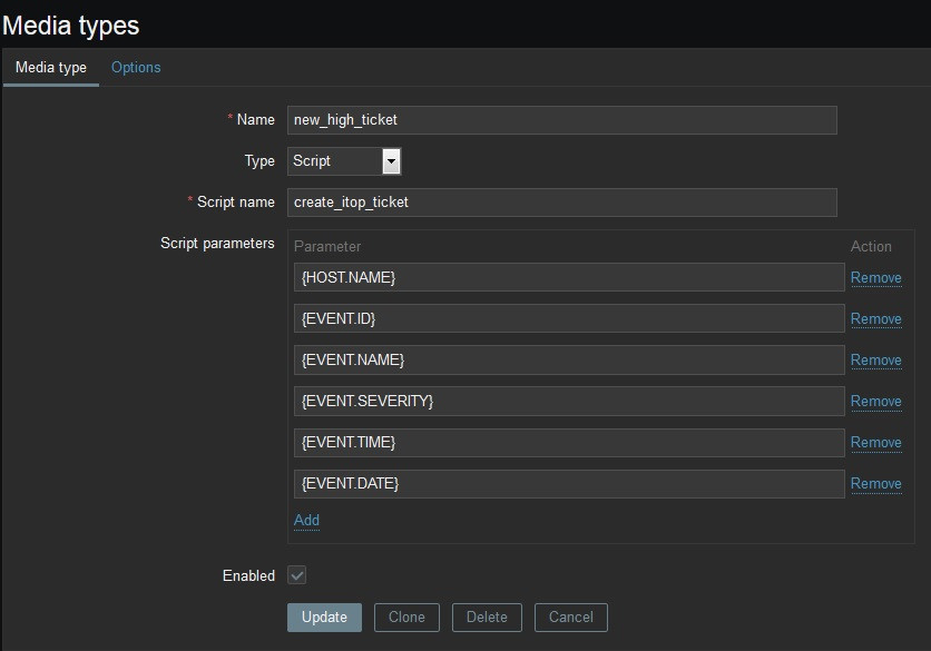

    Can you upload a screenshot of how it is configured in "Media Types" and in "Actions"?
    • ssalter
      • Mar 2019
      Attachments have been uploaded.

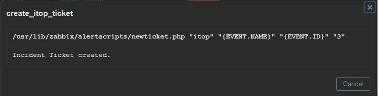

      Interestingly when I look at the dashboard and click the host that is in alarm, I can manually execute "create_itop_ticket" script and it will resolve the Host Name from the Macro, but not the Event Name or the Event ID (I have been playing around with which of the parameters I want to use and have settled on these.

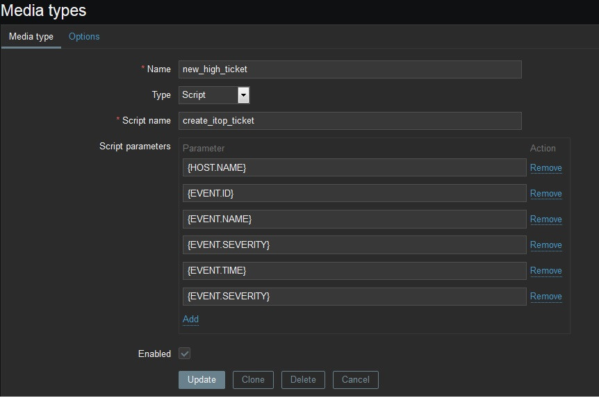

      • ssalter
        • Mar 2019
        Fixed a problem with the media type where I had the same parameter twice but it didn't resolve the overall issue. Updated screenshot attached.
