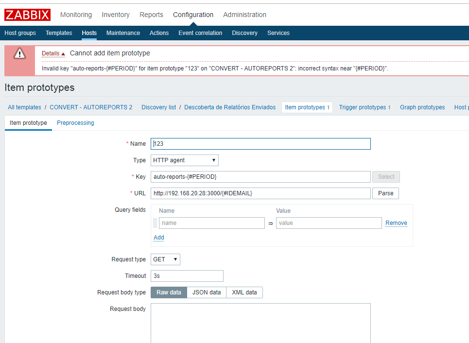

    2) If I try to put the variable name in key's name, it doesn't allow me to create the prototype (because of the type of characters):
    It doesn't allow me to create
    I don't know what to do, did anyone have some scenario like this?

    Thanks to Patrese Renan , I was able to make it work, just will update here if someone has the same problem:
    What you should do is create the key like this:
    auto-reports["{#PERIOD}","{#PARAM2}","{#PARAM3}"]
    Then it'll work.
