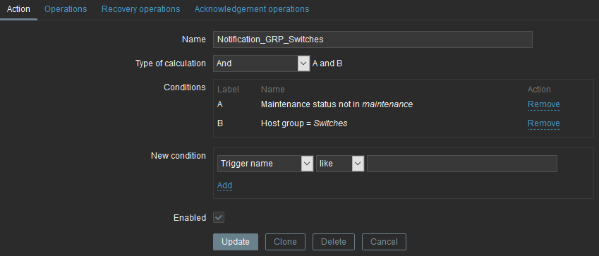

          if your hosts are of the same category eq. Server or Switch, then I recommend using host groups for the notification actions.
          You just have to change the Conditions from "Host = Switch XYZ" to "Host group = Switches".
          Attached a screenshot for you.
          Best regards
