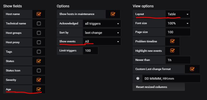

    You are using List layout mode for problems panel in Grafana; it doesn't show much in that layout. If you update plugin (version 3.10.0 has Table layout feature), Zabbix problems panel will come with Table mode by default, You may revert back layout to List mode but this Table mode shows much more with history&duration with the (i) column apper at the end of each alarm row.
    In edit mode, go to Options screen to check if you have these:

      I updated the plugin, and although the table does look more structured, the fields available didn't really change in regards to new ones. "Age" and "Show events All" were already available in the list layout. The Age field still only shows when the host problem was resolved, not for the duration of how long it was in a problem state.
