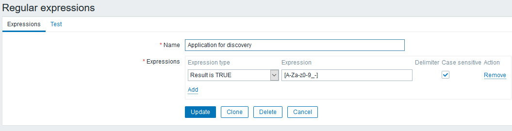

              I have faced the same problem, to have list of packages from linux and their versions, but didn't come to the point of checking if they are the right version and trigger the alert, but the bit I did may help you:
              I've created regular expression:

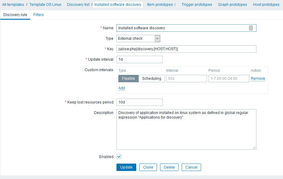

              Then discovery prototype item:
              Then php script:

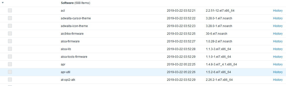

              And I've created application for it, called just "Software".
              And it looks like:
