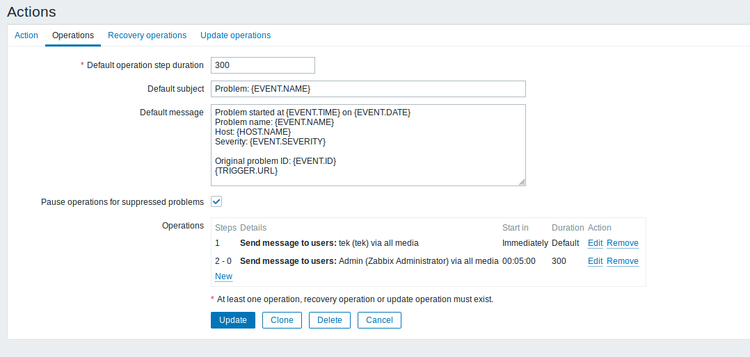

    We are using Zabbix4.0. Yesterday we have setup escalation matrix for one hostgroup we have setup 5 minute duration for next mail notification but we receive only single mail notification. Attached is my configuration for same:
    Can you please help me whats wrong with it.
    Thanks in advance.

    I have a similar scenario and it works. I guess that is because your first action has "Default" duration where it should have the duration to activate the second. Please follow the following:

      Hello Brunohi,
      Thank you for your response.
      My escalation matrix was fine but i had made mistake i.e i forgot to attach the hostgroup with that usergroup so notification was not sent to user for that host. Now i have added that hostgroup in usergroup and my escalation matrix is working fine.
      Thanks once again for your response.

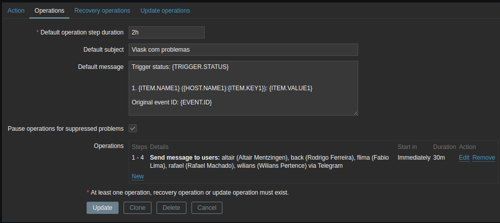

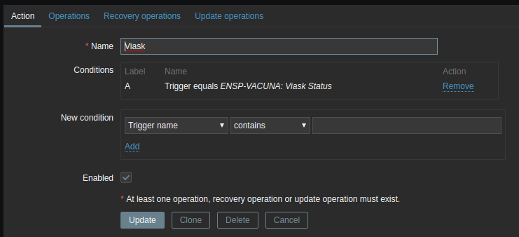

        I have this scenario
        • One Action to send notifications to users if one specific trigger started
        • Operations configured to send 4 Telegram notifications each 30 minutes if Not Ack for 2 hours
        It happens that only the first notification is sent
        Someone can help me? Is anything wrong in this configuration
