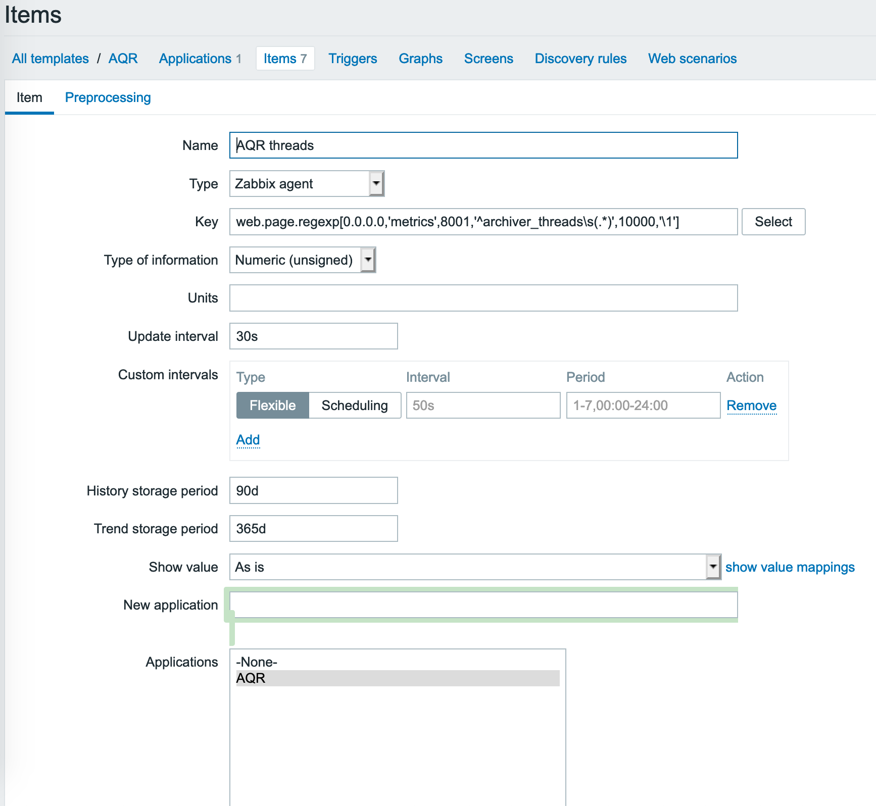

      Maybe special chars?
      Could you post a screenshot of your item config?
      • mysterysmith
        • Jul 2016
        • 12
        Here's what I got...

          Hi
          have to try to change the Type of information , flot to string or text ?
          iim not sure float is compactible with web.page..key
          • mysterysmith
            • Jul 2016
            • 12
            When changing it from "Numeric (float)" to "Text" the item goes from unsupported to working but still doesn't return any data
