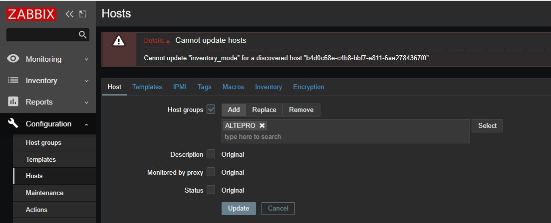

The error I receive for the syntax above is following:
zabbix_api.ZabbixAPIException: (u'Error -32500: Application error., Cannot update "inventory_mode" for a discovered host "501a2a20-60c3-7d91-b3c0-f0fad90ef59e". while sending {"params": {"hostid": "10952", "inventory_mode": 0, "inventory": [{"name": "Router 10"}]}, "jsonrpc": "2.0", "method": "host.update", "auth": "b86e2b4da0f641c3f6c78546ead95bc0", "id": 2}', -32500)
I have tried altering the Default Host Inventory Mode to "Manual" under Administration --> Other. I tried deleting all discovered hosts and re-discovered them and that didn't help.
I tried to set the Discover VMware VMs --> Host prototype template to both Manual and Automatic, and that didn't help either.
