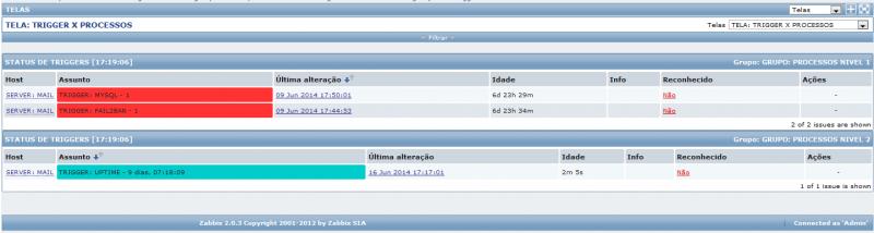

      It would be similar to the above example. Of course I have many more servers and more items to monitor, but that was just to illustrate. Today, when I mount the screen shows all configured triggers on both levels. Need to separate. Level 1 triggers a screen, no matter what process registered or host, level 2 trigger and a second screen, with the same criteria. Following picture of screens with the configuration I'm doing.
      Can you tell me if it is possible?

          Already tried that, but the problem is that the Dashboard in Last 20 issues shows all configured triggers. I need to be separated by level. As this example I rode. Is showing everything. I separate by color: Red - Critical; Blue - Non-Critical. It is a screen showing the processes of level 1 at the top and the level processes on the bottom 2. I have separated all monitored by level of criticality items. One would have to separate the triggers on screen: what is critical to the screen, which is not critical on another screen.

              Gentlemen, thank you for all the help. But it really has no way to do what I like Zabbix. The solution was to create a php screen that shows the way I need.
