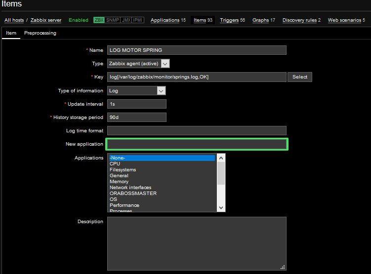

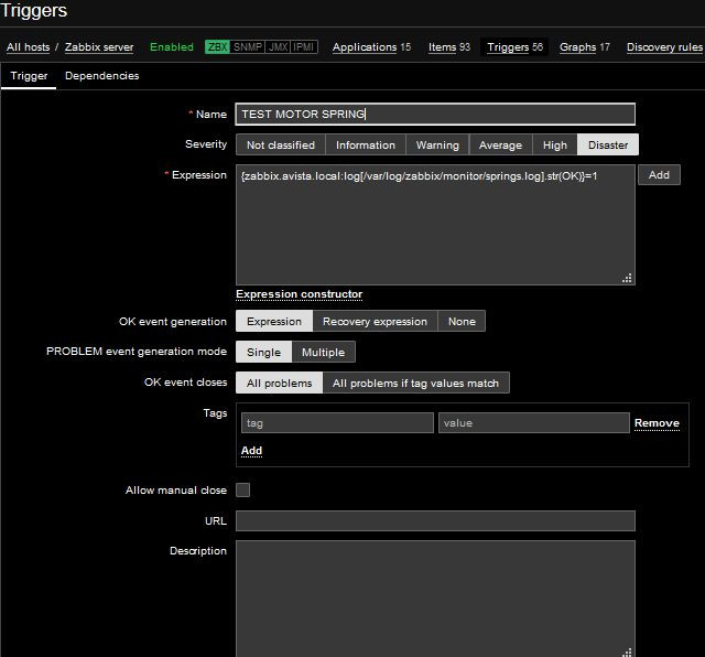

                Hello, I tried, tried, tried, but not successful
                Follow my configuration printout
                Status is *problem*

                • Atsushi
                  Atsushi commented
                  The item seems to be set to the host "Zabbix server", but the conditional expression in the setting of the trigger seems to specify the conditional expression to the item of the host "zabbix.avista.local". In this setting, even if the host "Zabbix server" acquires the corresponding log, the trigger event does not occur because the item is not specified in the trigger conditional expression.
                  If you use "log [/var/log/zabbix/monitor/spring.log, OK]" which is the key of the log item of host "Zabbix server" in the conditional expression of the trigger, As an item you specify in the conditional expression
                  You should specify "Zabbix server:log[/var/log/zabbix/monitor/spring.log,OK]" instead of "zabbix.avista.local:log[/var/log/zabbix/monidor/spring.log]" as the item specified in the conditional expression.

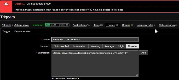

                It gives error when trying to change
