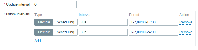

    You can left the trigger as {DELLRN7roc.num[notepad.exe].avg(1m)}=0 and to monitor process in predetermined periods of time, you can use “Custom intervals”, that are available in a chosen item configuration page, judging by your post, yours would look like that:
Name:	Screenshot from 2019-04-26 16-56-11.png
    The trigger will be active only when the new data will available.

      A small update, this will also result in monitoring item state only in mentioned intervals, so if it's not exactly what you are looking for, can you please describe in simple terms, how the proccess should be monitored - when the state is OK, and when the state should be PROBLEM (triggered), and should the item be monitored 24/7, but trigger active in mentioned times.

        With this "Custom intervals" it's don't work like that in this time the process is not monitored ?
        Example: Then my trigger change to offline (and show error in panel) in this "Custom intervals" when i set up to 0 the process will start so i still will be have a Error that process don't work ? (because it's don't check )
        • lagavazzz
          • Apr 2019
          • 21
          Glad you found the issue.
          Sorry, I was under impression that you are trying to monitor if the notepad.exe is on during 1-5 --> 8:00-17:00, 6-7 --> 00:00 - 00:00. then the solution with custom intervals could work.
          If you are trying to monitor whether the notepad.exe is off, outside of mentioned times, then your trigger is more appropriate.
