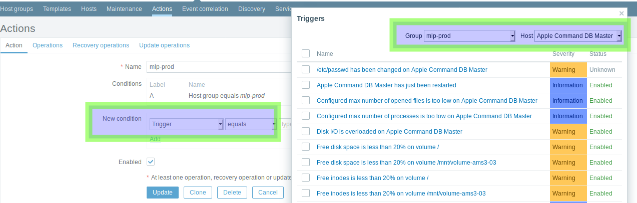

      In Action condition which value we should use? Because i have multiple hosts in one hostgroup. I want alert for some specific resources and services. How we can use it can you please guide me? Because when i select trigger then its showing all the triggers and need to choose host. So as per my understanding, here we can set the trigger per host. am i right?
      Please refer the attached screenshot.
      But if its true then it will be long process to set the triggers per host in Actions. Can you please help me little bit more so we can get only alert for specific services.
      Thanks in advance.

        There are several ways to do it. I would recommend you to work with TAGS or Applications, as you can filter them in your Action Configuration.
