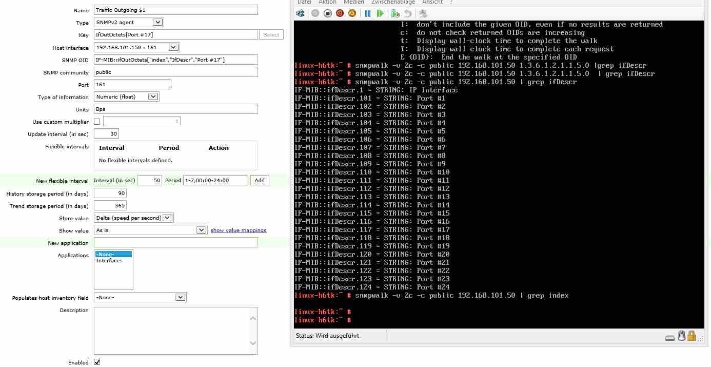

      thanks for the tipp, but i got still an error.
      On the Availability section, i got a Red SNMP Sign with the message:
      Timeout while Connection to "192.168.101.150:161"
      Thanks in advance
      Daniel

        • Daniel4711
          • Jul 2014
          • 127
          On the console i got a timeout too... but then i realized that i got a difference with the ip address.
          See the Screenshot above..
          The Discovery works fine!
          many thanks!
