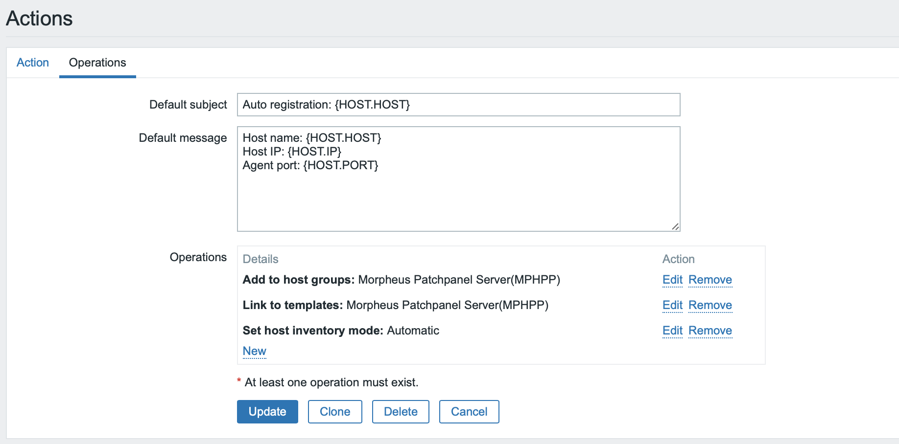

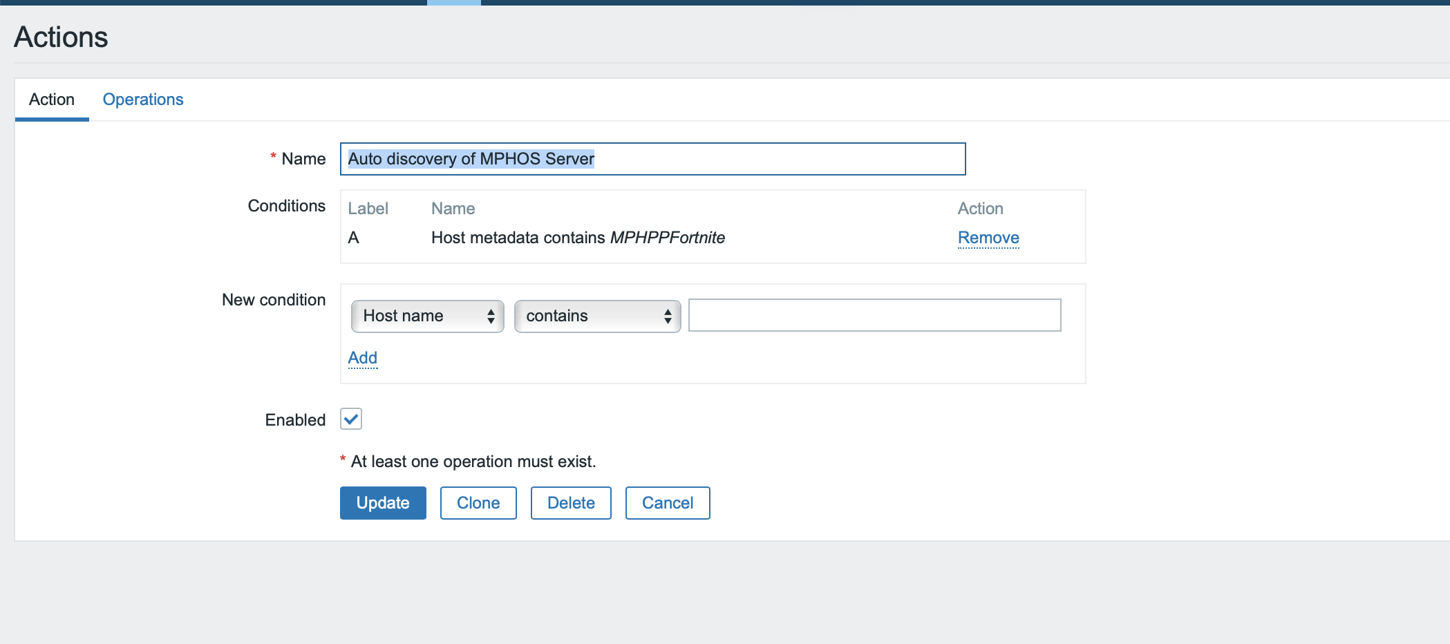

    From UI
    These are the configuration I have done in UI. But the host is not auto-registering.
    Can someone help me?

    pls fix the "Action" screenshot. And pls note "HostMetadataItem is only used when HostMetadata is NOT defined" (if you define HostMetadata - no need define HostMetadataItem and viсe versa)

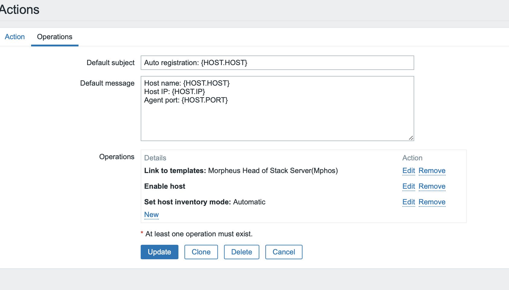

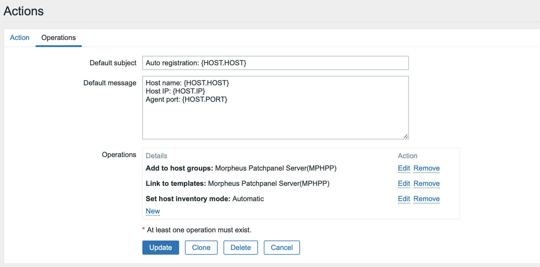

      In The UI
      • Supriya123
        • Jun 2019
        • 17
        I have updated the agent configuration file to only refer to HostMetadata. But still it is not auto-registering. Here is the configuration

        In The UI, I have defined these values. Attached are the screen shot. Can you please help me?
