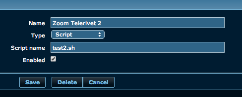

    I read the page on Custom Scripts. Zabbix seems to always pass my email address as the first argument to my custom script, not the value I specified on the Media Type.
    Here's my script, test2.sh -- I've hard coded the email address so that I can capture the first argument in the email body:
    #!/bin/bash
    to=$1
    subject=$2
    body=$3
    cat <<EOF | mail -s "From Script: $subject" "[email protected]"
    to: $to
    subject: $subject
    body: $body
    EOF

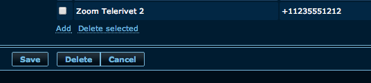

    I defined this as a system-wide media type and I added the media type to myself with a Send to value of +11235551212.
    Should I not be getting +11235551212 as the first argument to test2.sh? $1 is always my email address.

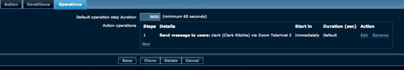

    Are you sure, that your Action in Configuration --> Actions is referring to you "Zoom Telerivet 2" and not any other media type?
    • clarkritchie
      • Aug 2013
      • 46
      Thanks for the reply.
      Yes, see attached -- my action is using my "Zoom Telerivet 2" media type.

        Interesting. I just ran through this again, top to bottom. $1 is always my email address.
        On my user account, under Media, Email is the first item, then some test media entries, finally my custom Zoom Telerivet media type.
        For grins, I disabled Email on my account, ran my test again, and $1 was correct: I got the phone number specified for the Zoom Telerivet media type on my account. Great!
        I just re-enabled Email media type and ran my test again, and $1 is still correct -- the phone number.
        So maybe this was a quirk on my account. Disabling/reenabling the default media type cleared something out.
