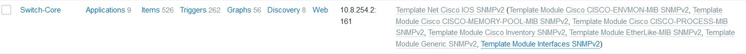

    I have an alert that from time to time pops up, it's regarding a switch, I would like to disable, not the alert on dashboard but the email notification on it.
    How do I go about doing that?

      I am using Zabbix 4.0.5, not understanding what's referenced by "ignore setting"
      This particular "ignore" I want is for a Cisco Switch port alert. Can I be guided through a little bit more?
      So I click on the alert that I wanna edit, the one on the attachment but I get kind of lost afterwards

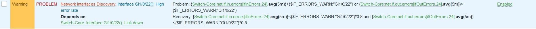

        Trigger configuration:

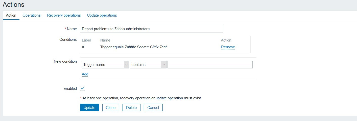

        Action configuration

          So whenever I go to that trigger, it's all grayed out and I cannot edit it. Should I delete it and create a new one with the same expressions?

            Probably because it's linked to a template, so you should either edit there or create a custom trigger on the host.

                  So I created a new trigger with same expressions on the Cisco Switch triggers. It's a different name, but it contains the same expressions and the tag not to send emails. How will this work or which one will have precedence over the other? Should I link to template?

                    Did you disable the other one, related to the template? (Because if you have both of them active, one will still send the notification).
                    • Erudes
                      • May 2019
                      • 17
                      Yes, I disabled it, I think I dont need to configure the actions part.
                      Does the attachment mean that we onnly going to receive emails from that alert specifically?
