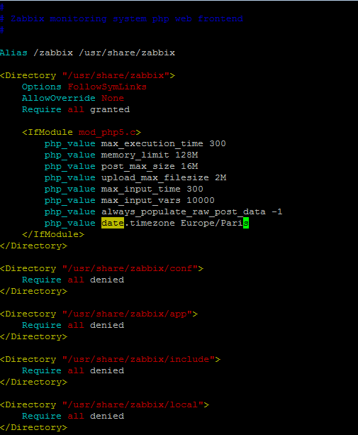

    • gdelabre
      • Jun 2019
      Thanks for your help,
      I made the configuration and reboot zabbix server
      but the error is still displayed. Can it come from another file?
ID:	381244Click image for larger version
      • Atsushi
        • Aug 2013
        • 2028
        What version of PHP are you using?
        If you are using PHP 7.x and mod_php, you need to change "mod_php5.c" to "mod_php7.c".
        If you are using php-fpm instead of mod_php, you will need to configure it in /etc/php.ini.
        • gdelabre
          • Jun 2019
          I am in version 5.4 for PHP.
          The problem is solved it was necessary to change the time zone in php.ini and do "httpd reload".
