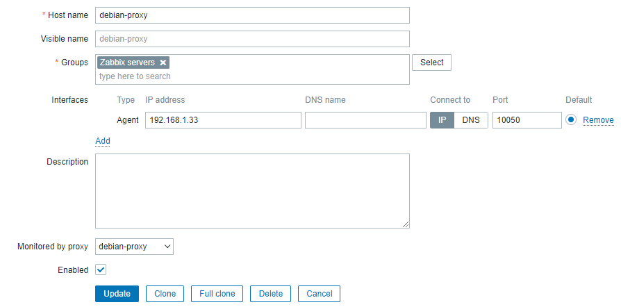

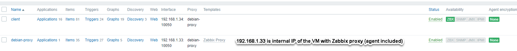

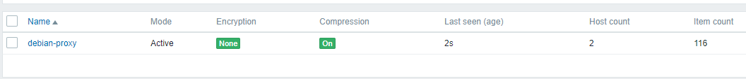

      Hello ingus.vilnis and thank you very much for the reply. Could you please assist a bit with my problem as well..
      I did what you've wrote above, but for me it does not work well... Since I'm complete newbie in that questions - I would really appreciate your advices.
      I've set up a home lab with the following configuration:
      zabbix-proxy active
      host with the same name as proxy has and template for Zabbix Proxy
      host details
Name:	host details.png

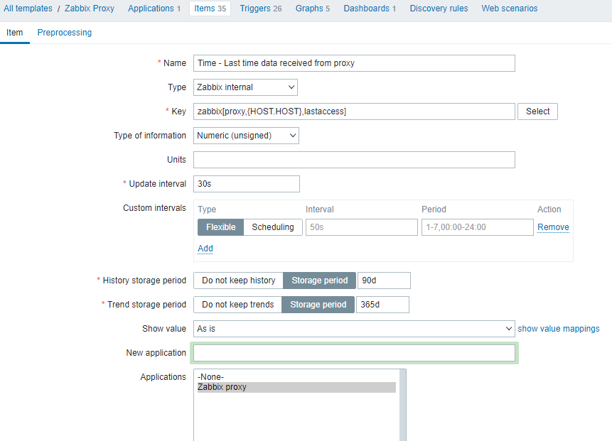

      I've created the new item in the template Zabbix Proxy
Name:	templates - new item created.png

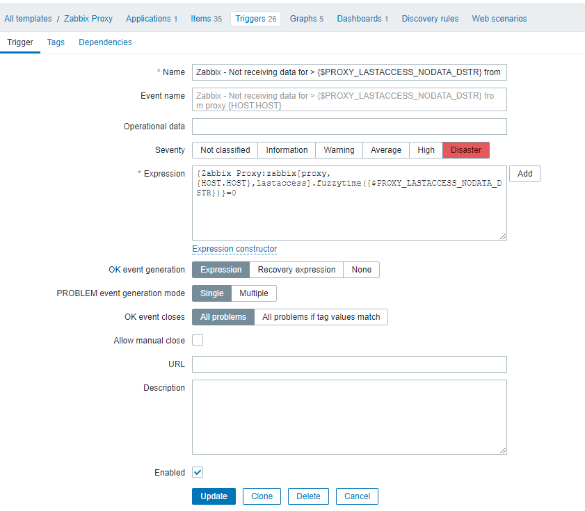

      and I new trigger with the names, advices by you
Name:	templates - new trigger created.png
      After I turn off the proxy I have no data in the "Monitoring > Problems" area.
      Could you please tell me what I did wrong ?
