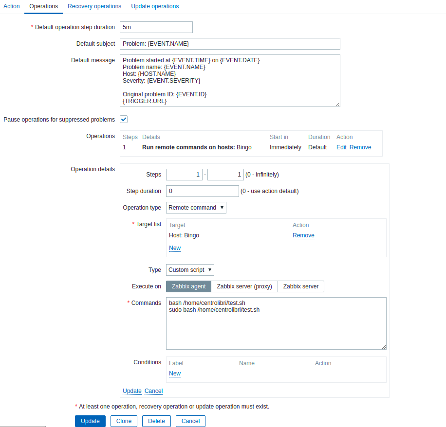

    Hi all!!!
    I have a question...i need to launch a script "test.sh" with the agent of zabbix in a linux machine
    Example: test.sh ---> /sbin/poweroff
    (chmod +x done)
    in the /etc/zabbix/zabbix_agentd.conf i have the "EnableRemoteCommands=1"
    The Visudo is edited for the zabbix (i put the line "zabbix ALL=NOPASSWD: ALL")

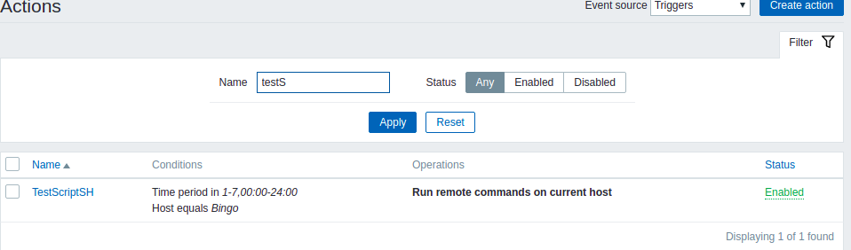

    But how i can write on the zabbix server "when i see this trigger on, start this script?" and how can i test it?
    In photo as i have modified the "action" on the zabbix-server
    Thanks all

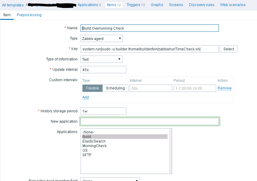

    I run shell scripts with Zabbix and I do it as items on hosts, I have it set up like this
    then I have a trigger based on the output of the script.
    Hope that helps
