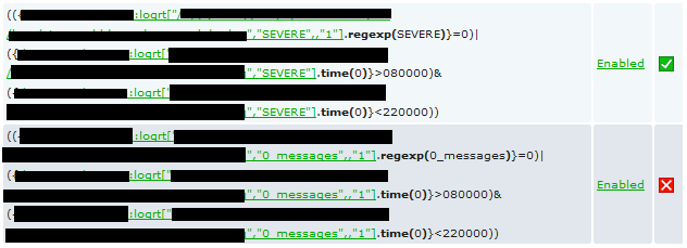

I’ve made the item using https://www.zabbix.com/documentation...ypes/log_items
Enabled and no error
So i moved on to make a trigger
(({servername:logrt["path/to/log","SEVERE",,"1"].regexp(SEVERE)}=0)|
({servername:logrt["path/to/log","SEVERE"].time(0)}>080000)&
({servername:logrt["path/to/log","SEVERE"].time(0)}<220000))
And
(({servername:logrt["path/to/log","0_messages",,"1"].regexp(0_messages)}=0)|
({servername:logrt["path/to/log","0_messages",,"1"].time(0)}>080000)&
({servername:logrt["path/to/log","0_messages",,"1"].time(0)}<220000))
The error is for the trigger is:
Evaluation failed for function:…….
Ofcourse the time lap is for the sms we want that something is wrong, not for the timeframe in de log file

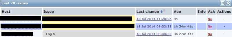

At the dashboard you can see the trigger (for SEVERE) is on.
how can i add the time frame for monitoring the log file in the trigger.
Or how can i let the trigger read only the last line in the log file
