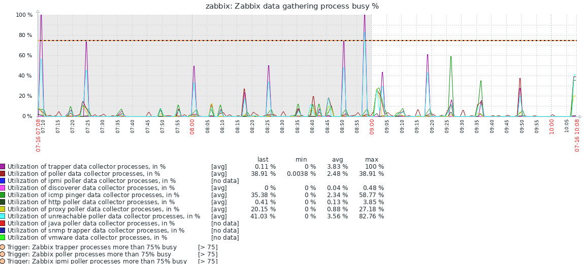

      and then few Unreachable events occured

          • ingus.vilnis
            Zabbix Certified Trainer
            • Mar 2014
            • 908
            Upgrade alone will be no help if you have such high values for started processes set in the configuration file.
            In Template App Zabbix Server there are five graphs that very well illustrate the health of Zabbix server. based on the reading all settings in the config file can be adjusted. You can show them all here to have more insight along with all currently configured values in the config file.
            • ilia
              • Dec 2018
              • 37
              since upgrade it seems good,
              maybe the upgrade did some sort of flush or clean some values

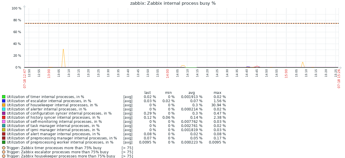

              here are the charts: first with the load upon start, and second excluding startup load
ID:	382589Click image for larger version
              • ingus.vilnis
                • Mar 2014
                • 908
                When you receive the "false" alerts, are there really gaps in the collected values from those hosts? Compare one such time when you receive the alert with graphs from that host.

                  • ingus.vilnis
                    • Mar 2014
                    • 908
                    12:20 Pollers busy + UnreachablePollers busy = Network problem where Zabbix can't connect to devices it monitors.
                    Not sure what spikes you mention but go to Monitoring -> Latest data or Graphs for any device which had this agent unreachable alert and carefully look if you have all the values with exact timestamps collected at the problem period.
