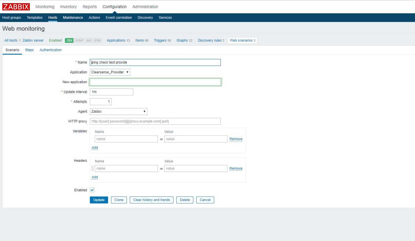

    I am trying to create web scenarios to monitor the health checks of an URL
    Below are the screenshots that shows the things I have done
    Click image for larger version  Name:	web scenarios.PNG Views:	3 Size:	52.8 KB ID:	382665

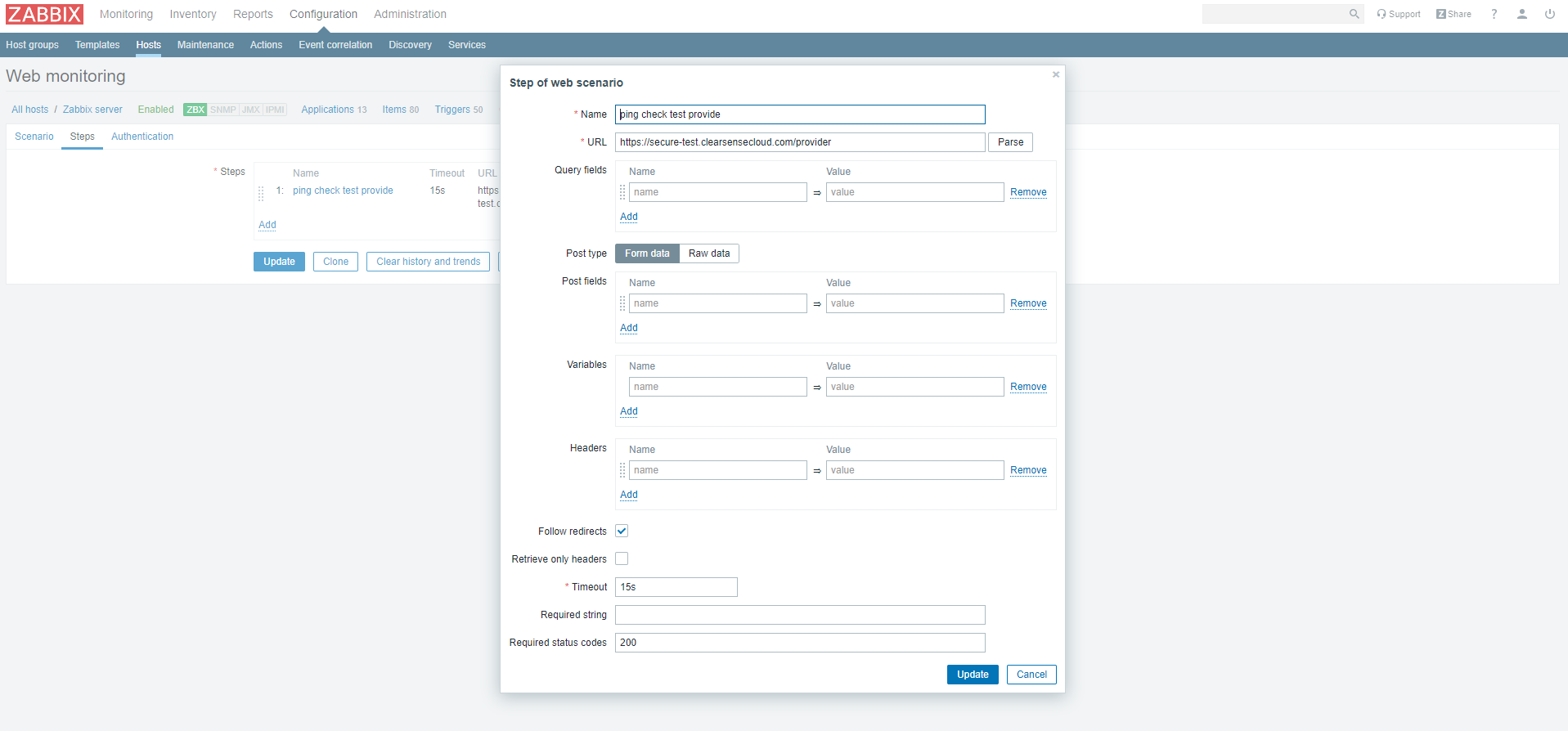

    Steps for web scenarios
    Click image for larger version  Name:	web scenario step.PNG Views:	1 Size:	78.4 KB ID:	382666

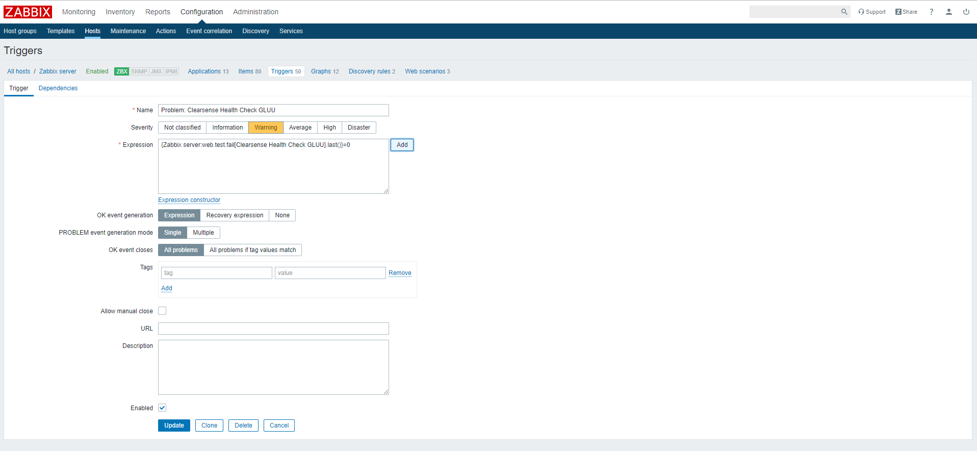

    Trigger for Scenario
Name:	trigger for web scenario.PNG
    Can some help me in checking the health checks for the URL.

      Hey Bruno,
      I have created a trigger as shown in the above screenshot but when the server is UP it is saying as problem and when it down it says the server is working fine(I set it kinda reverse and dont know how to make it work)
      What should I have to do to make it work perfectly?

        The response status code is set to 200

          {Zabbix server:web.test.fail[Clearsense Health Check GLUU IDENTITY].last()}<>200
          Please check whether it works or not
          • brunohl
            Zabbix Certified Specialist
            • Mar 2019
            • 215
            Yeah, but you should see if sometimes the server is not returning an other code that doesn't represent a failure (a 300 for instance) and maybe check if the item that check for errors is returning something different than an empty string. The other thing is that maybe you want to increase verification time to don't be fooled by false positives.
            I use my web check triggers like:
            {SRV-FTP-BACKUP-CONVERT:web.test.rspcode[Convert Video Cloud - Redeagro,Entrar no Site].last()}>399 or {SRV-FTP-BACKUP-CONVERT:web.test.fail[Convert Video Cloud - Redeagro].last()}>0
            • yash_25
              • May 2019
              • 41
              I have added this {Zabbix server:web.test.rspcode[Clearsense Health Check GLUU IDP,id-test.clearsensecloud.com IDP].last()}>399 or {Zabbix server:web.test.fail[Clearsense Health Check GLUU IDP].last()}>0 and will check the trigger and let you know.
              • yash_25
                • May 2019
                • 41
                In my case it is working too. Thanks Bruno, you are awesome

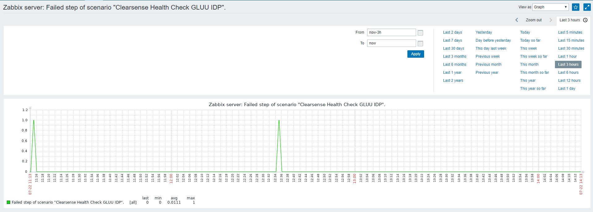

                    Could you please explain this and also how to resolve this?
                    • brunohl
                      • Mar 2019
                      • 215
                      At those spikes one of your steps failed on your web scenario check. This could mean that your internet oscilated on that period or some other thing. I guess that's not too much to worry about.
