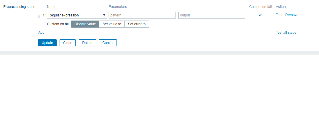

          thanks but now i have this error with Type of information
          Numeric (unsigned)Numeric (float)CharacterLogText :
          4776:20190725:111925.817 error reason for "" changed: Preprocessing failed for: 39056000
          1. Failed: cannot perform regular expression "^(\d*)\.\d*$" match for value of type "string": pattern does not match
          • Hamardaban
            Hamardaban commented
            It's a value without a dot and the pattern did not fit. Use pattern ^(\d*)\.?\d*$
