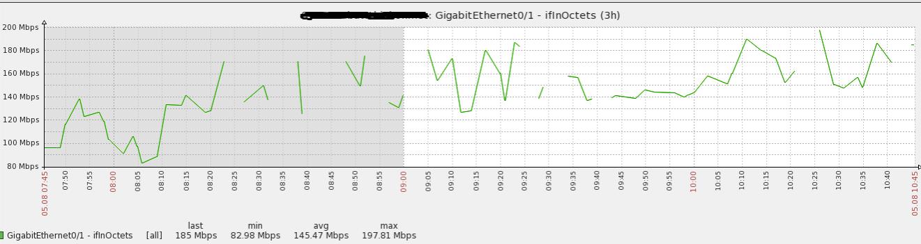

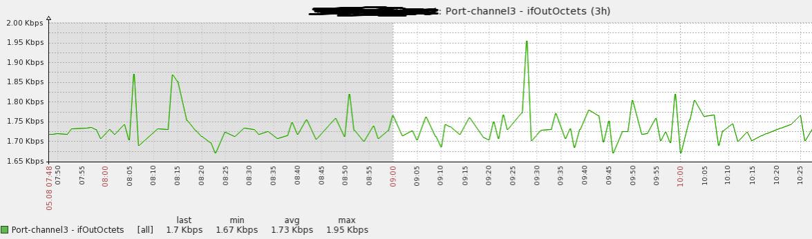

    I got a juniper switch, some of the interfaces are broken graphs, some are not. These are just basic SNMP low level discovery interfaces. please see pictures.
    Any reason for this and how can I troubleshoot this?
    thanks.

            seems it is crossing the 32bit range:
            IF-MIB::ifInOctets.10101 = Counter32: 3789997922
            The number 2,147,483,647 is also the maximum value for a 32-bit signed integer in computing.
            I am not sure , but this counter32 should be caculated as GAUGE in zabbix

            • filipp.sudanov
              Zabbix Certified Specialist
              • May 2014
              • 137
              See if your equipment has 64 bit counters, like ifHCInOctets
