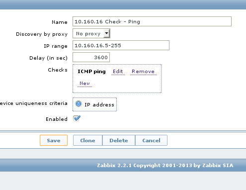

        • clayton940
          • Jul 2014
          • 21
          Aleksey,
          I did as you suggested and created an action to remove a host if not "discovered" for 24hours and it works it does remove it. However if you check the discovery tab the host still exists and is red.
          How do I get it removed from the discovery list.
          see attached...
