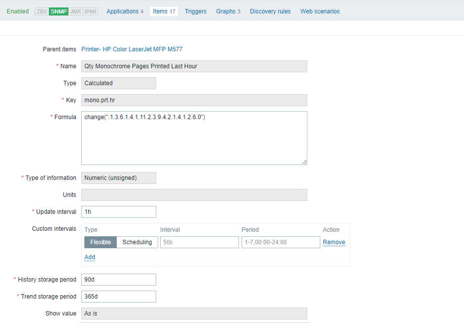

      Hamardaban
      Thank you for the reply. Just make sure I understand you correctly this is what your refering too..
      • Gsmith
        • Mar 2015
        • 56
        Hamardaban
        Had to make a correction to the Formula change(".1.3.6.1.4.1.11.2.3.9.4.2.1.4.1.2.7.0",360 0). It works now. Thank you for the advice, much apperciated.
