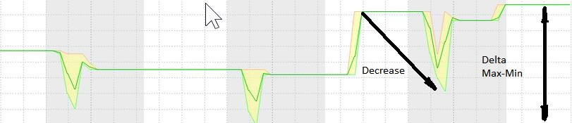

    Max() - Min(), or for that matter Delta() calculates a difference, it returns always a positive number
    I would like to know the slope instead. Specifically the biggest decrease size of the last two weeks.
    This is good for forecasting, much better than any linear extrapolation.
    To put it in graphics
    Click image for larger version  Name:	2019_08_23_15_34_35_History_refreshed_every_60_sec._Firefox_Developer_Edition.jpg Views:	1 Size:	30.5 KB ID:	384895
    Yes, this is free disk space, and Delta() is not good enough because what is needed is exclusively Usage Growth while ignoring any Space Addition (How much space my app is known to allocate in a given period)
    Is it possible to calculate this in some way with the available functions?

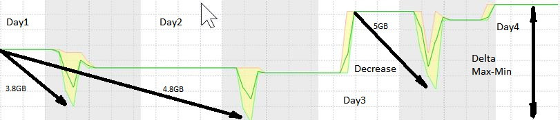

      Using "Slope" might be unfortunate. I am not looking for the angle. I need a MAX - a MIN that happened later in time. The largest one.
      Reusing the graph above:
      Click image for larger version  Name:	2019_08_23_15_34_35_History_refreshed_every_60_sec._Firefox_Developer_Edition.jpg Views:	1 Size:	37.8 KB ID:	384903
      If every square is 1GB
      On Day 2 the Largest previous decease is 4.8GB - 1GB = 3.8GB
      On Day 3 the Largest previous decease is 4.8GB - 0GB = 4.8GB (>3.8GB)
      On Day 4 the Largest previous decease is 7.2GB - 2.2GB = 5GB (>4.8GB >3.8GB)
      Until I find a solution I am using the built in delta() which gives me a usable but exagerated value
      On Day 2 -> 3.8GB
      On Day 3 -> 4.8GB (Morning)
      On Day 3 -> 7.2GB (Evening)
      On Day 4 -> 7.8GB

          Actally the graphs here were only to help me explain which value I am looking for (to be use in a trigger), no need to present anything
          All I need is (function/formula to get) the 5GB value (on day4/now)
          That represents the max space allocated/used recently. This helps the trigger know if there is enough free space (at least 5GB) or the disks need to be enlarged.
          This helped on day 3, there was a Warning saying I needed at least 4.8GB free (therefore the disk that day was enlarged 5GB from 3.2GB free to 7.2GB
          But on day 4 it is telling me that the disks need at least 7.8GB free and sends another warning, whereas I needed only 5GB now free to be on the safe side (because it is taking into account the new MAX I created), and there is no need for a warning (since 7.8GB are enough at the moment)
