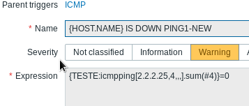

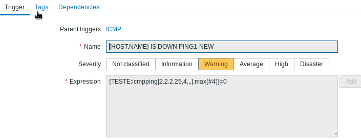

            My trigger:
            Click image for larger version  Name:	001_trigger.PNG Views:	2 Size:	18.9 KB ID:	385332

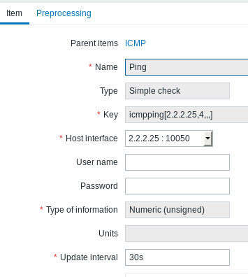

            My item:
            Click image for larger version  Name:	001_item.PNG Views:	2 Size:	19.4 KB ID:	385333

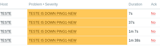

            Firing intervals:
            Click image for larger version  Name:	001_firing.PNG Views:	1 Size:	15.5 KB ID:	385329
            Same happens even changing with sum() function as you suggested:
            As you guys can see, the trigger is firing every 30 seconds. My expectation is that it fires at every 120 seconds (interval set by max function in the trigger itself).
            Is that the expected behavior, or am I missing some key concept over here??
