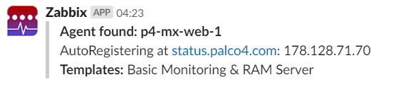

    Whenever I run this script I get an alert like
    Click image for larger version  Name:	33.png Views:	1 Size:	24.8 KB ID:	386791
    As you can see the script uninstalls and reinstalls the agent, whenever is run so there should be no problem on seeing the autoregistering alert several times each time the script is run.

    and we got exactly this (I'm reusing the image from above, be assured that this is the one that triggered)
    He did it in another server and the same happened, and in both servers, there were no changes at all in the host configuration itself

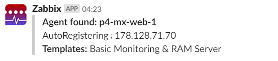

    I just found out that If you upgrade the Linux kernel this will trigger an alert about host information changing (and after a reboot, trigger a new auto registration).
    enter image description here
