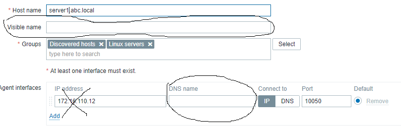

    Hi guys,
    I have configured agent autodiscovery as well. But I have question: Is it posible fill on GUI in Agent interface DNS name? Example in screen.
    Thank you.

      Hi Anthony,
      thank you. This is ok, but I need set hostname in "Agent Interface" field on GUI by autodiscovery.
      By autodiscovery agent I need to setup these things :
      - hostname
      - visible name
      - agent interface = hostname
      Detials are in the attachment.
      Thank you.
      PS : in nutshell what we are trying to achieve is to setup automatic discovery and population of data from the agent to the zabbix server.
      Current approach with manually modifying the zabbix_agent.conf is not OK for us.
      We can setup a template for the configuration but the template must act as default for all machines aka HostnameItem=system.hostname[host]
