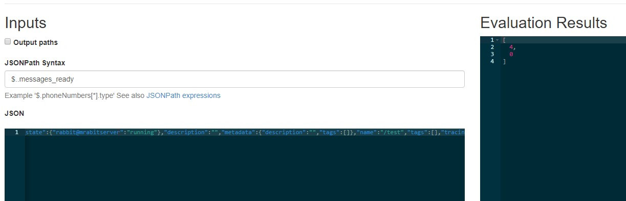

            Connected another host. Now I get data from two hosts. I get something like 4.6. How to take only the first number?
            Json
            [{"cluster_state":{"rabbit@rabitserver":"running"},"description":"dev","message_stats":{"ack":4024744,"ack_details":{"rate":0.0},"confirm":5868689,"confirm_details":{"rate":0.0},"deliver":4025051,"deliver_details":{"rate":0.0},"deliver_get":4025052,"deliver_get_details":{"rate":0.0},"deliver_no_ack":0,"deliver_no_ack_details":{"rate":0.0},"drop_unroutable":0,"drop_unroutable_details":{"rate":0.0},"get":1,"get_details":{"rate":0.0},"get_empty":0,"get_empty_details":{"rate":0.0},"get_no_ack":0,"get_no_ack_details":{"rate":0.0},"publish":5868940,"publish_details":{"rate":0.0},"redeliver":308,"redeliver_details":{"rate":0.0},"return_unroutable":0,"return_unroutable_details":{"rate":0.0}},"messages":6,"messages_details":{"rate":0.0},"messages_ready":6,"messages_ready_details":{"rate":0.0},"messages_unacknowledged":0,"messages_unacknowledged_details":{"rate":0.0},"metadata":{"description":"dev","tags":[]},"name":"/dev","recv_oct":43806019749,"recv_oct_details":{"rate":137.6},"send_oct":20151641087,"send_oct_details":{"rate":67.2},"tags":[],"tracing":false},{"cluster_state":{"rabbit@rabitserver":"running"},"description":"","messages":0,"messages_details":{"rate":0.0},"messages_ready":0,"messages_ready_details":{"rate":0.0},"messages_unacknowledged":0,"messages_unacknowledged_details":{"rate":0.0},"metadata":{"description":"","tags":[]},"name":"/migr","recv_oct":2149349,"recv_oct_details":{"rate":317.0},"send_oct":474654,"send_oct_details":{"rate":69.2},"tags":[],"tracing":false},{"cluster_state":{"rabbit@rabitserver":"running"},"description":"","metadata":{"description":"","tags":[]},"name":"/test","tags":[],"tracing":false}]

            • gofree
              • Dec 2017
              • 400
              if your sure thatthe order of the clusters will not change ( /dev, /migr /test } aka the json output will stay the same all the time you can use preprocessing again - regexp pattern (.*),.* output \1

                 [{"cluster_state":{"rabbit@rabitserver":"running"},"description":"dev","message_stats":{"ack":11488185,"ack_details":{"rate":0.0},"confirm":16898701,"confirm_details":{"rate":0.0},"deliver":11489059,"deliver_details":{"rate":0.0},"deliver_get":11489089,"deliver_get_details":{"rate":0.0},"deliver_no_ack":0,"deliver_no_ack_details":{"rate":0.0},"drop_unroutable":0,"drop_unroutable_details":{"rate":0.0},"get":30,"get_details":{"rate":0.0},"get_empty":0,"get_empty_details":{"rate":0.0},"get_no_ack":0,"get_no_ack_details":{"rate":0.0},"publish":16899909,"publish_details":{"rate":0.0},"redeliver":839,"redeliver_details":{"rate":0.0},"return_unroutable":0,"return_unroutable_details":{"rate":0.0}},"messages":0,"messages_details":{"rate":0.0},"messages_ready":0,"messages_ready_details":{"rate":0.0},"messages_unacknowledged":0,"messages_unacknowledged_details":{"rate":0.0},"metadata":{"description":"dev","tags":[]},"name":"/dev","recv_oct":119680992170,"recv_oct_details":{"rate":420.0},"send_oct":50428536867,"send_oct_details":{"rate":121.6},"tags":[],"tracing":false},{"cluster_state":{"rabbit@rabitserver":"running"},"description":"","message_stats":{"ack":6897,"ack_details":{"rate":0.0},"confirm":5381,"confirm_details":{"rate":0.0},"deliver":6897,"deliver_details":{"rate":0.0},"deliver_get":6897,"deliver_get_details":{"rate":0.0},"deliver_no_ack":0,"deliver_no_ack_details":{"rate":0.0},"drop_unroutable":0,"drop_unroutable_details":{"rate":0.0},"get":0,"get_details":{"rate":0.0},"get_empty":0,"get_empty_details":{"rate":0.0},"get_no_ack":0,"get_no_ack_details":{"rate":0.0},"publish":5381,"publish_details":{"rate":0.0},"redeliver":0,"redeliver_details":{"rate":0.0},"return_unroutable":0,"return_unroutable_details":{"rate":0.0}},"messages":0,"messages_details":{"rate":0.0},"messages_ready":0,"messages_ready_details":{"rate":0.0},"messages_unacknowledged":0,"messages_unacknowledged_details":{"rate":0.0},"metadata":{"description":"","tags":[]},"name":"/migr","recv_oct":169431647,"recv_oct_details":{"rate":626.6},"send_oct":47458182,"send_oct_details":{"rate":135.2},"tags":[],"tracing":false},{"cluster_state":{"rabbit@rabitserver":"running"},"description":"","message_stats":{"ack":7,"ack_details":{"rate":0.0},"confirm":7,"confirm_details":{"rate":0.0},"deliver":7,"deliver_details":{"rate":0.0},"deliver_get":7,"deliver_get_details":{"rate":0.0},"deliver_no_ack":0,"deliver_no_ack_details":{"rate":0.0},"drop_unroutable":0,"drop_unroutable_details":{"rate":0.0},"get":0,"get_details":{"rate":0.0},"get_empty":0,"get_empty_details":{"rate":0.0},"get_no_ack":0,"get_no_ack_details":{"rate":0.0},"publish":7,"publish_details":{"rate":0.0},"redeliver":0,"redeliver_details":{"rate":0.0},"return_unroutable":0,"return_unroutable_details":{"rate":0.0}},"messages":3,"messages_details":{"rate":0.0},"messages_ready":3,"messages_ready_details":{"rate":0.0},"messages_unacknowledged":0,"messages_unacknowledged_details":{"rate":0.0},"metadata":{"description":"","tags":[]},"name":"/test","recv_oct":49521,"recv_oct_details":{"rate":0.0},"send_oct":23244,"send_oct_details":{"rate":0.0},"tags":[],"tracing":false}]

                      • ind2
                        • Oct 2019
                        • 14
                        The solution was simple.
                        For example:
                        value: 100,9,1300
                        $.[0].messages_ready = return 100
                        $.[1].messages_ready = return 9
                        $.[2].messages_ready = return 1300
                        Thank all for your help!
