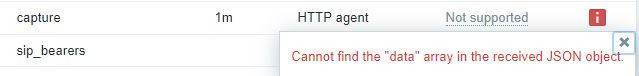

    Looks very simple but I'm getting the below error
    Any clue on what I'm doing wrong?

    What is the detailed version of Zabbix you are using? Assuming Zabbix 4.0, when using LLD, it is necessary to use the format shown in the following URL.
    If LLD processing is performed directly, the following formats are not supported.
    {"id":[103,101,104,102]}

      Thanks for your reply.
      I'm using Zabbix version 4.4.0 and understood that "since Zabbix 4.2, the format of the JSON returned by low-level discovery rules has been changed. It is no longer expected that the JSON will contain the "data" object."
      Am I misunderstanding something ?

        Anyone to confirm there is no way to perform LLD whith such JSON data ?

          Isn't it possible if you receive JSON in the following format?
          [{"id":"103"},{"id":"101"},{"id":"104"},{"id":"102"}]
          • 20k
            • Apr 2017
            • 18
            My goal was actually to have many discovery rules, all depending on a same HTTP item which returns a JSON containing different type of items at different paths in the JSON.
            Then I suppose this cannot be achieved as long as the root element MUST be "data", is my understanding right?
