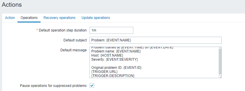

Valentines Thanks for your reply.
I have configured the trigger and I have also received the alert but the issue I don't get the name of URL which is down. So it great if you tell how can I will get the URL name in an email:-
Problem started at 03:14:53 on 2019.11.06 Problem name: url monitor Host: test Severity: Warning Original problem ID: 1225 Can you help on this

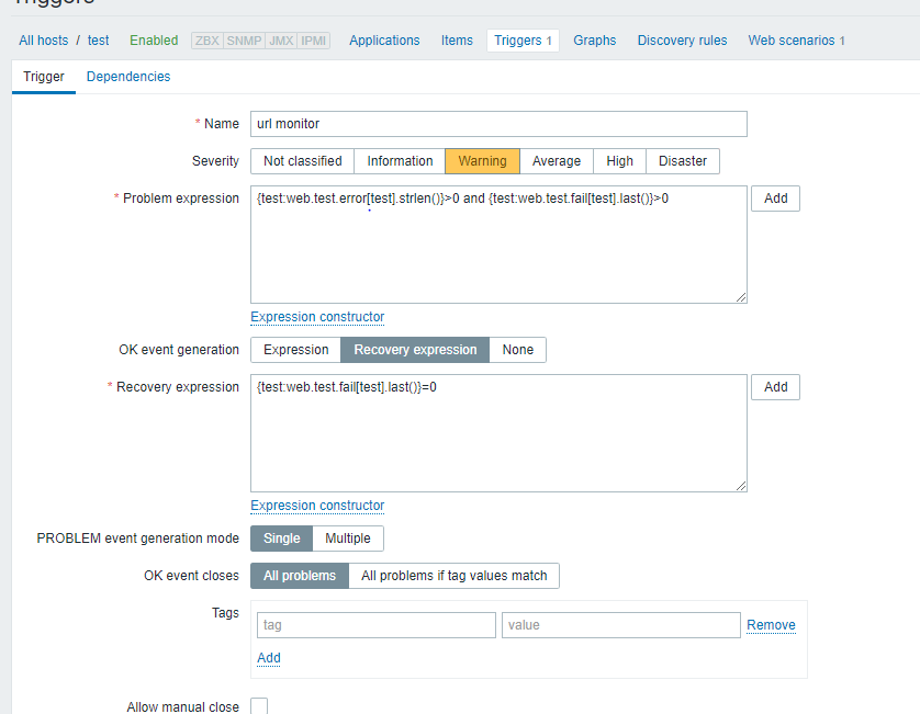

You can try this option.
Put two expressions for the trigger
Then add following to the Trigger description:Code:{host:web.test.error[Scenario].strlen()}>0 and {host:web.test.fail[Scenario].last()}>0

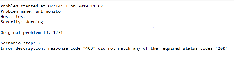

Scenario step: {ITEM.VALUE2} //Last value of second item in trigger expression
Error description: {ITEM.VALUE1} //Last value of first item in trigger expression
Then in action you can use macro {TRIGGER.DESCRIPTION} which will populate your notification with number of step that failed and error message received.Comment

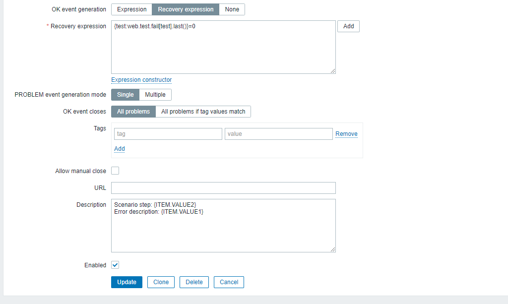

Do you have the Description field at very bottom of trigger configuration? I don't see the whole configuration on your screenshot.
Put these two lines into description field.
Code:Scenario step: {ITEM.VALUE2} Error description: {ITEM.VALUE1}Comment
