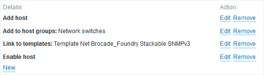

    So now I have a SNMPv3 template ready, I added a switch (Host), filled the macros and tested it, it works fine. I have 170 switches, it is impossible to add them manually. Hence I did a discovery rule for the IP range, and created an action shown in the attached image below. during discovery, how can I fill the macros above for the action to work as intended in order to automatically add those switches to hosts secion.
    Click image for larger version  Name:	2019-11-19 10_22_33-Window.png Views:	0 Size:	10.0 KB ID:	390215
