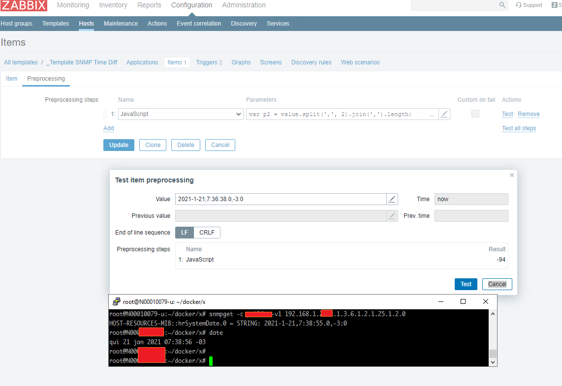

            Here is my scrren with tests.
            I'm using the same timezone in both, server and host
