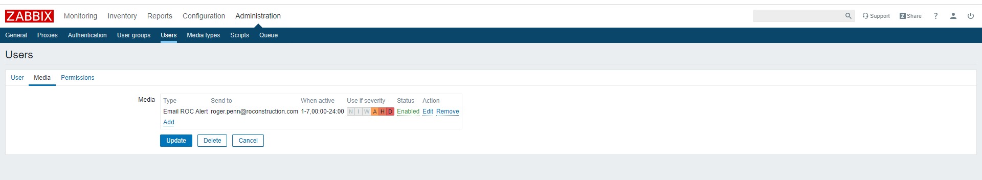

    • Roger Penn
      • Feb 2020
      I am having this same issue. Both users have the media defined and both are getting the same error. Email sends fine via the test mail. Would really like to know what is going on because this whole thing is useless if we can't get notification when things go wrong. Click image for larger version

      • Atsushi
        Atsushi commented
        Is the user or user group set as the destination for operation in the action settings?

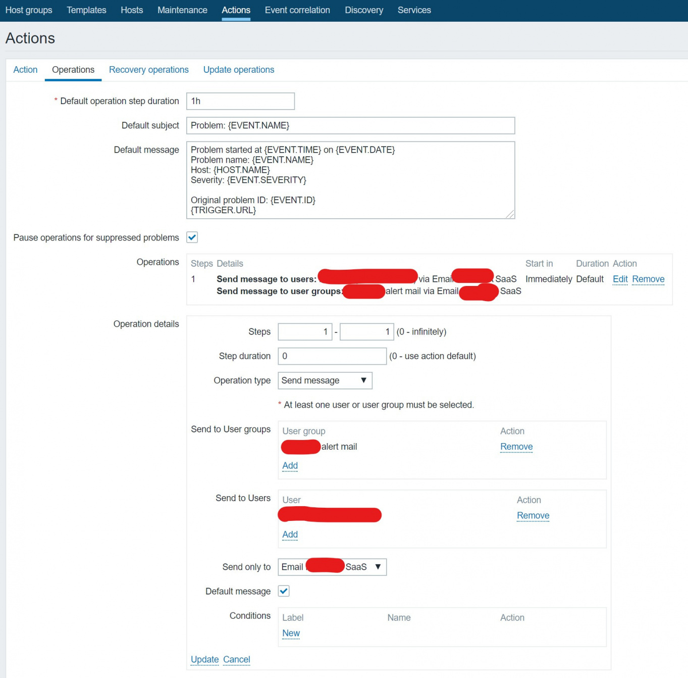

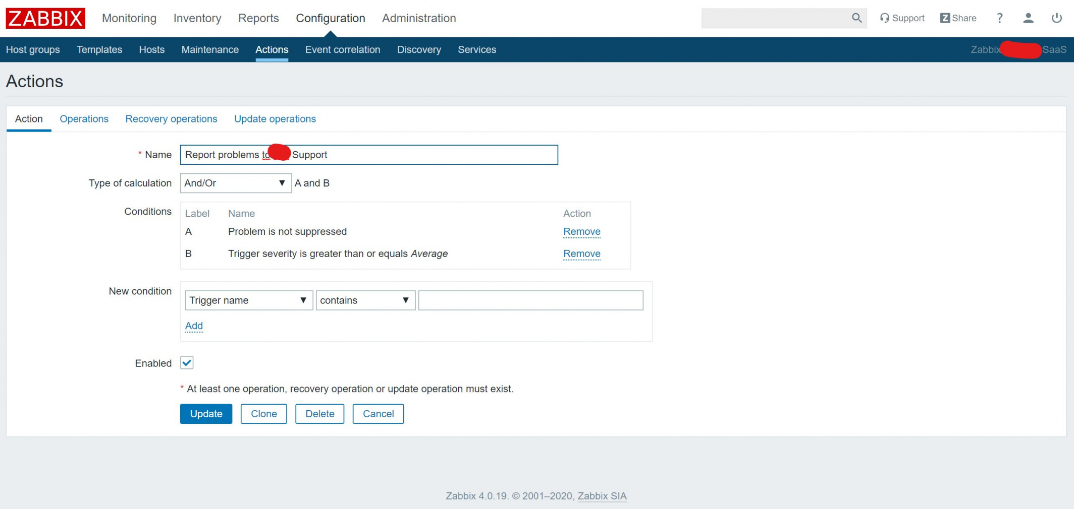

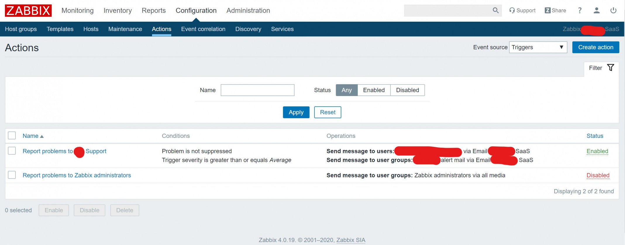

                tim.mooney Thank you for your answer.
                Yes, the triggers work correctly and are displayed in the dashboard and in Monitoring-> Problems.
                I also configured the action to send email to a group and a single user as you can see from the screenshots.
Name:	Annotazione 2020-04-20 101540.jpg

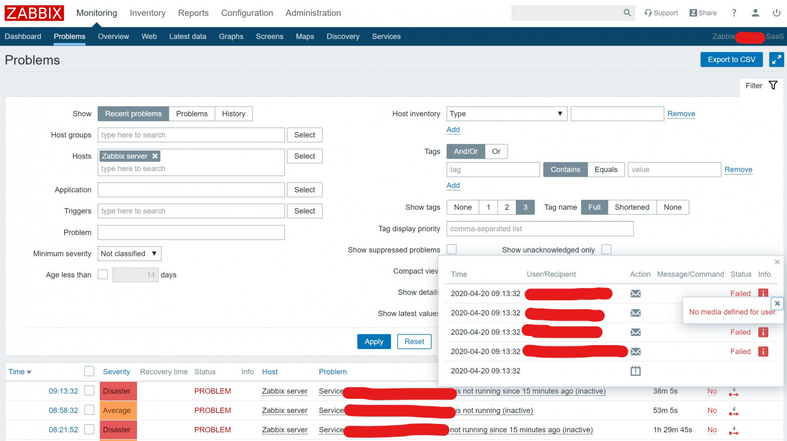

                • FauP
                  • Apr 2020
                  .... tim.mooney Thank you for your answer (sorry I'm new in the forum).
                  I have also configured the action to send email to a group and a single user as you can see from the screenshots, but in the dashboard I always find the alarm that the email is not defined for users.

                  • tim.mooney
                    • Dec 2012
                    • 1436
                    Your triggers are detecting problems and generating events, so the problem is not with your triggers. Thanks for providing that information, to rule out the triggers.
                    I understand the need to obscure parts of the screenshots, but that does make it more difficult to spot what the problem is. However, based on how wide certain obscured fields are, there's something I want you to check.
                    In the first screenshot you posted, with the Media setup for a particular user, the Type of media is just "Email".
                    In the Action->Operations screenshot, in the Operation details area the "Send only to" box is set to something that looks like a different media type, "Email SOMETHING_OBSCURED SaaS". That appears to be a different media *type*.
                    In other words, your user is configured to have just one media type, "Email", but your Action is trying to send to both the group and the user via the "Email SOMETHING_OBSCURED SaaS" media type. I'm pretty sure that's why you're getting the "No media defined for user."
                    If you want to use your Action exactly as it's configured, then you need to give the user (and user group) the additional media type "Email SOMETHING_OBSCURED SaaS".
                    Alternately, you need to modify your Operation conditions to use the Media type "Email", instead of "Email SOMETHING_OBSCURED SaaS".
                    I don't know which one is correct for your environment, but if you use "Send Only to" in an operation condition in an action, then that exact media type has to be one that your users have assigned to them.
                    • FauP
                      • Apr 2020
                      Ok tim.mooney , Thanks for your suggests, I think have found a problem. For each users I need change media Type, I must select the new action "Email SOMETHING_OBSCURED SaaS" and not default "Email".
                      Now I have the system without connectivity to SMTP server, but now don't have the error message "Failed. No media defined for user".
                      The new message on Monitoring->Problems->Action is "In progress, 3 retries left", but I don't see any TCP requests coming out of Zabbix to the SMTP Server.
                      I hope to complete my test tomorrow by connecting to the SMTP Server.
