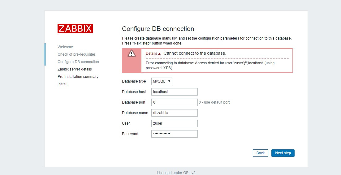

    i install centos 7 on vm (vmware) and install apache mariadb and config all things good
    but when connect to database error
    please help me for resolve this problem
    i think my configure database is fail bus i cant solve it

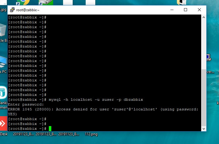

    Does "mysql -h localhost -u zuser -p dbzabbix" work on the host?

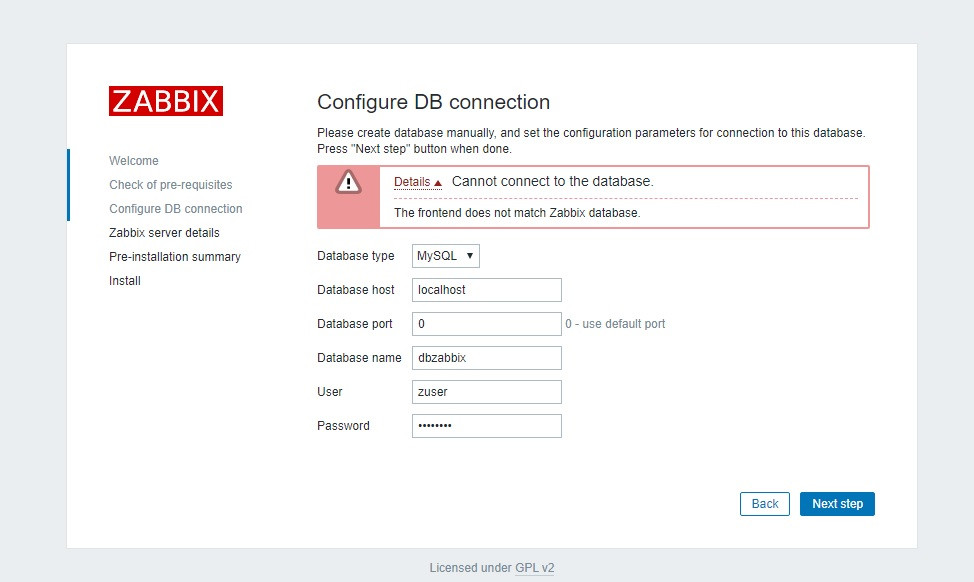

      Did you register the initial data after creating the database for Zabbix server? Zabbix will not work just by creating an empty database.
      ex.
        i run this command on my host ask me password i write password correctly but access denid!!!

            Try use "127.0.0.1" instead of "localhost". That may sounds absurd but mysql is picky regarding host content on grant table.
            If that fails either, install phpmyadmin and check db's, tables and grant information.
            EDIT: 'zuser'@'localhost' and `zabbix_user`@'localhost' are not same. Try "zabbix_user" on web configuration.
            And db names also. If your db name is`zabbix_db` then use it on web configuration. Your screenshots clearly indicates that you are typing different db and user names for mysql.
