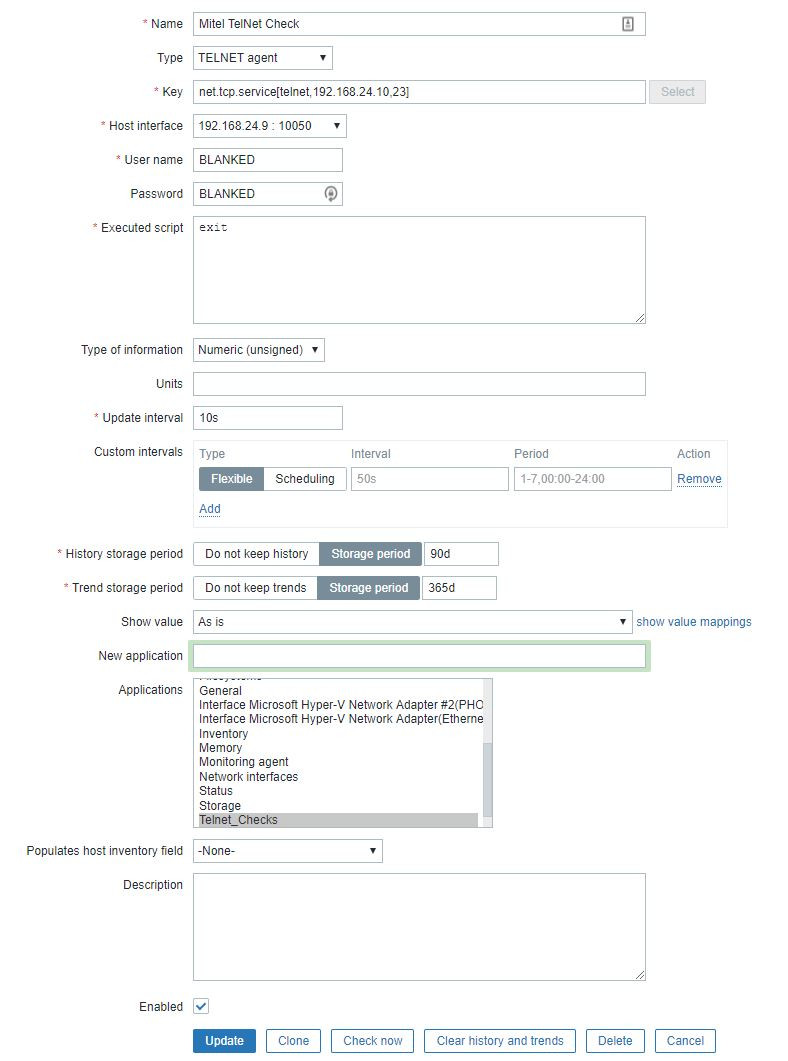

    I have a virtual windows server with two network adapters.
    One as a 10.2.x.x ip, the other has 192.168.x.x - this is to allow communication on the main office vlan and the separate phone vlan.
    I have monitoring on the 10 range sorted as per a normal windows server but I would like to set up a telnet check to check connectivity from the host, using the 192.168 address to a telnet enabled device on the same IP range.
    below shows the config I have set up for it, and I am getting a "0" on the check but the telnet is working.
    Any advice would be great.
    Thanks.

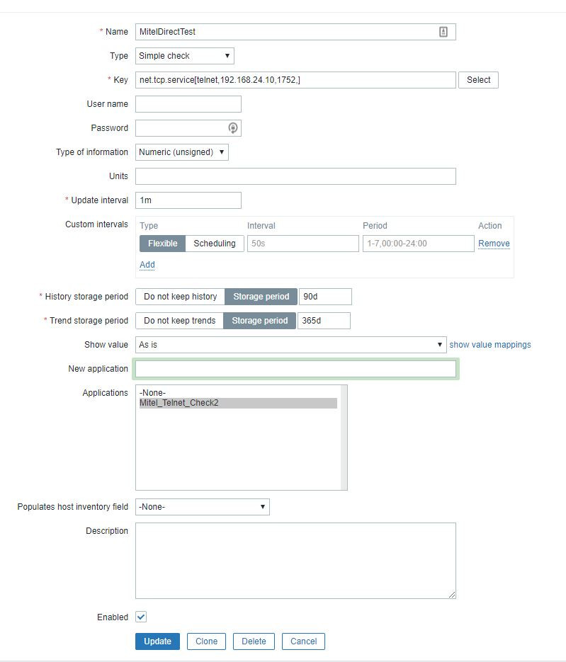

    To add,
    I have added the 192.168 adapter into the host config on Zabbix to alolow me to specify it in the item, I haven't done anything to the agent config on the host.
    Also, I have tried this with the same lack of successs.

      • gofree
        • Dec 2017
        • 400
        I guess you need to cahnge zabbix item type to zabbix agent as simple checks are being performed from zabbix proxy/server.
        from docu:
        Simple checks are normally used for remote agent-less checks of services.
        Note that Zabbix agent is not needed for simple checks. Zabbix server/proxy is responsible for the processing of simple checks (making external connections, etc).

            • gofree
              • Dec 2017
              • 400
              guess you have the item wrong - the simple checks chceck if service is available and accepting connection - so basically your last check checks if telnet service is runnin on the ip you specified and listens port you specified = this os not a replacemenet to "telnet ip : port"

                        • gofree
                          • Dec 2017
                          • 400
                          if the port 1752 is not a port (custom port for telnet ) of telnet service running obviosuly your ceck will not work - because youre trying to check if telnet is running and responding on port 1752
                          I guess this port is port of another service ( not telnet ) which youd like to check - so basically you need to check if that port is responding - try net.tcp.port[<ip>,port] on zabbix agent or maybe simple check in this format net.tcp.service[tcp,192.168.24.10,1752]
                          • Coxroach1
                            • Mar 2019
                            • 24
                            Thanks alot gofree , the net.tcp.service[tcp,192.168.24.10,1752] check works a treat!
