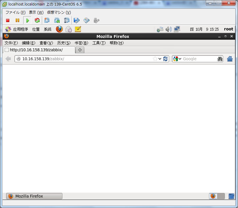

    Zabbix admin page turned to blank after the server reboot
    we installed Zabbix 2.4.1 in CentOS 6.5(VM), it was working for a while but once we restarted the server, we can not open the http://serverIP/zabbix page again.
    Anyone have good ideas about this? thank you.

                  Hi, i think we have found the root cause:
                  vi /etc/selinux/config
                  modify the status of SELINUX=enforcing to SELINUX=disabled (need reboot)
                  Hope this can help others who have the same problem as us.
