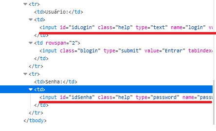

    Senhores!
    How can I create a login step to tog in in my web page and relate it if one arror happens?
    I already tried to follow the man on zabbix web page but no success.
    How can i archive it? My webpage does not inform any error when login is not OK, all status are "200"
    Can someone help me? or give one usable example?

    Probably the 200 status don't mean that the login worked.
    Can you send a picture of your item configuration?
    Also, try to make a login using CURL, and 'transpose' the parameters to your item.

      I tried to use CURL but it not work in our environment for security reasons;
      Have you any idea how can I do that? I know with Java it would be easy but I dont have good skills for programming it.
      Now i'm using the basic {idSenha} as Passw0rd and {idLogin} as user like the documentation.
      I just need to test if the login works fine but it seems to be pretty confuse todo on zabbix. In fact i dont see any stuff or how to to helpe me.
      Any help will be appreciated!

        Did you tried zabbix web-monitoring with native login function, or login by POST? And after that fined some string on page witch will approve that log in was successful ?

          If Curl didn't work the http agent will not work too.

            I`m talking about web-monitoring, not http-agent, I`m not really sure, but it could work.
