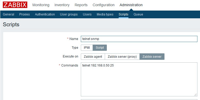

        send please screenshot of yours email settings, and what exactly is on console when your trying telnet 192.168.0.50 25 , also try to execute "telnet 192.168.0.50 25" as script on server(create in Administration-> scripts and then run on zabbix server in the web-GUI):

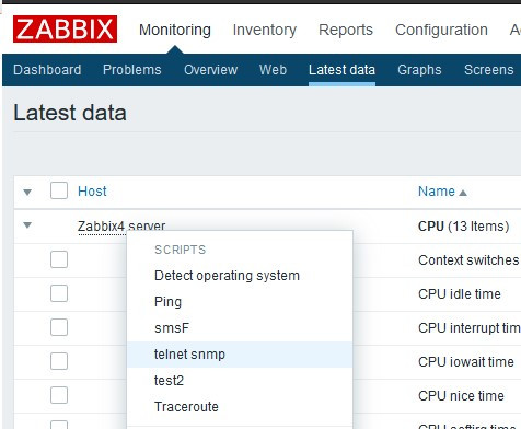

          Zabbix telnet script
          -Trying 192.168.0.50...
          -Connected to 192.168.0.50.
          -Escape character is '^]'.
          -Connection closed by foreign host.
          -Cannot execute script

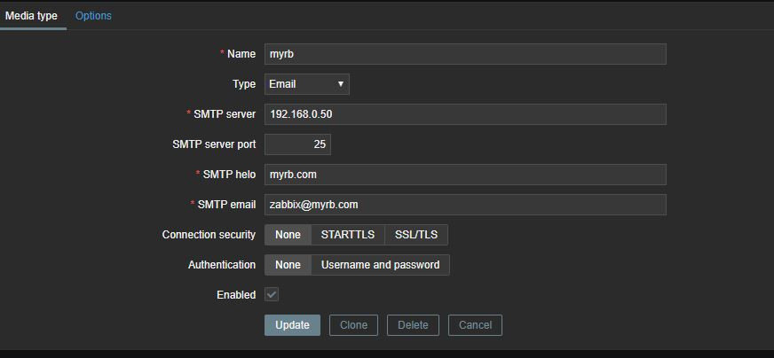

          SMTP settings
          Click image for larger version  Name:	myrb.JPG Views:	0 Size:	43.0 KB ID:	392088

            No It`s ok, zabbix actually see the SNMP-server, I really don`t understand what going on..
            Try at first set the DNS-name on snmp server field, not IP.
