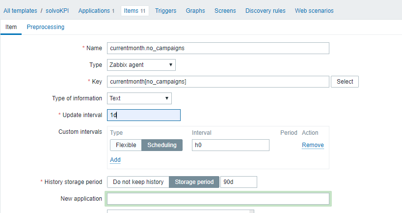

    retrieve item value as scheduled

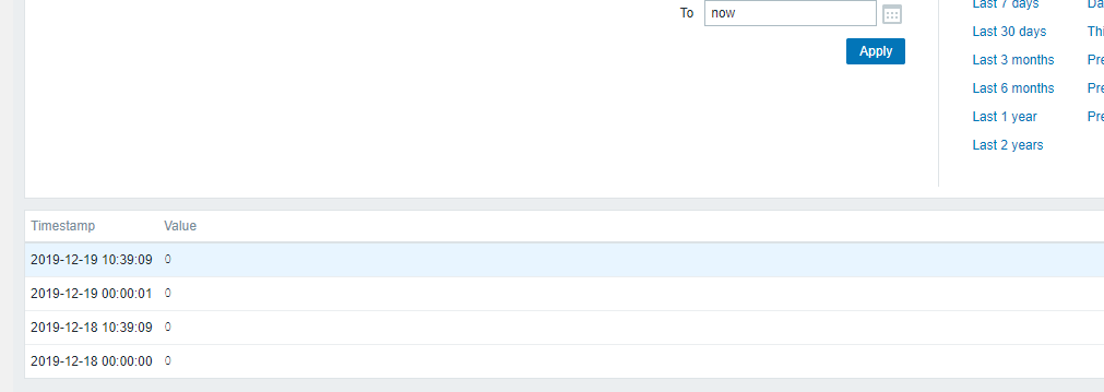

    I would like to retrieve item value one time each day. Therefore, I have configured the scheduler to execute on 00:00:00 and update interval is 1 day. However, when I checked the latest data, it displays two times each day. Are my configurations incorrect? I have attached screenshot of my configuration and latest data. Could you please help? Thanks in advance.

    you need just set the delay = 0
    and scheduling like h0
    now you have 2 values course one works ones in h0, and other every 1 day.

      Thanks. I have fixed with setting update interval "0"
