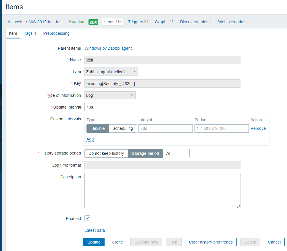

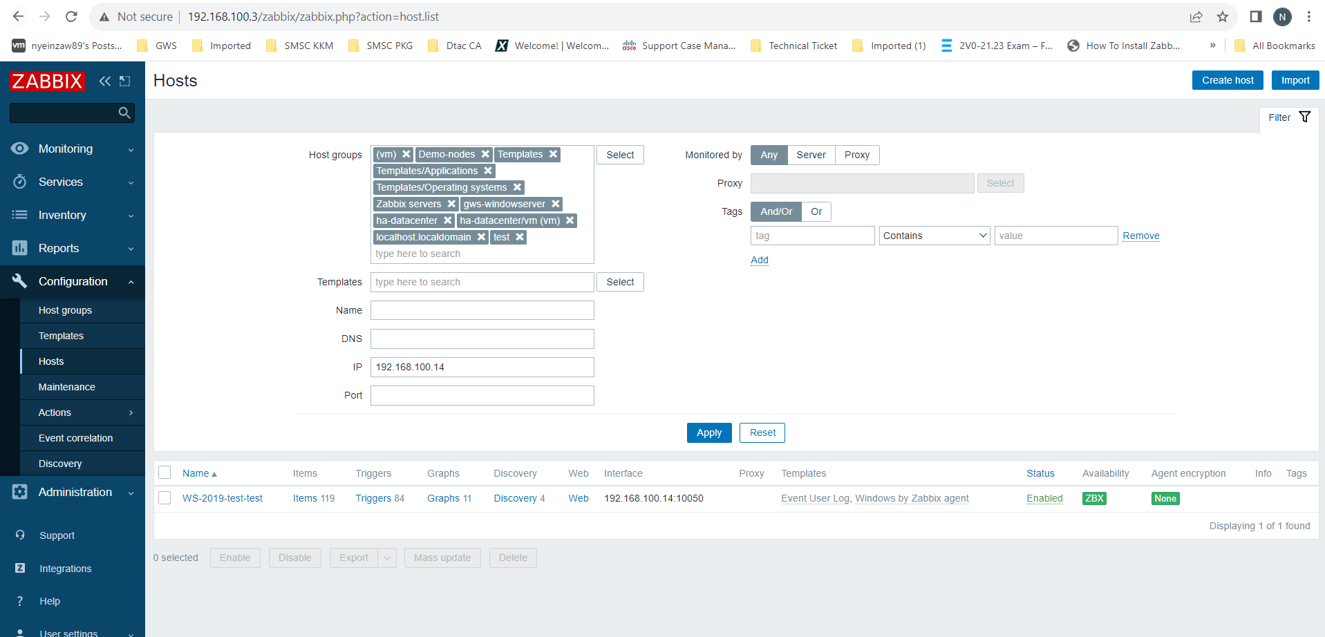

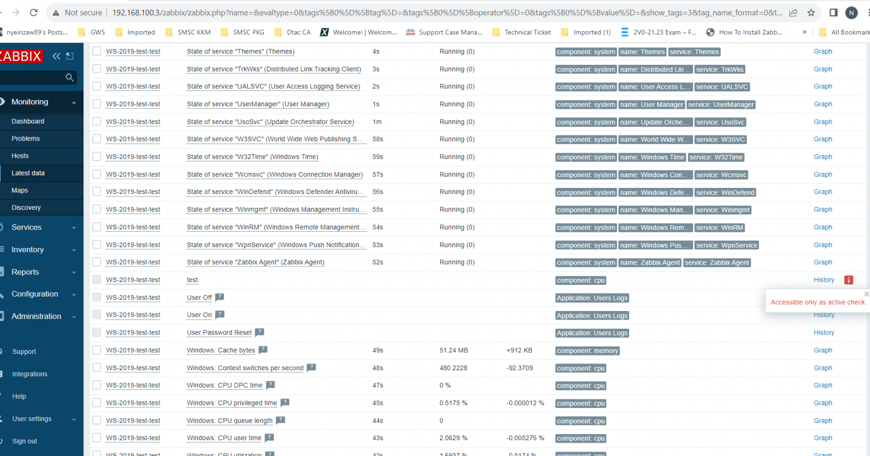

    Dear all,
    I setup zabbix agent on AD pc and turn on security audit, then I create a template just for monitoring windows event log from that AD. I tried many item that I collect from the internet but no ones work althought the connection is okay and others data are showed normally. I just want to monitor event about user logon/logoff. Any ideas?
    Thanks all.

    eventlog[Security,,,,^4625,,skip]
    Use this

          Edit Zabbix Agent config with
          Server = Zabbix Server IP
          ActiveServer = Zabbix Server IP
          Hostname = FQDN of host​

          Use "eventlog[Security,,,,^4725,,skip]"
