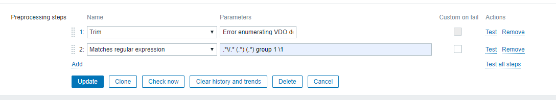

    Hi, i am using regular expressions in processing steps.
    This is my string:
    Device Size Used Available Use% Space saving%
    /dev/mapper/vdo_smb 100.0G 24.1G 75.9G 24% 99%
    i want to extract the 24% , that is the Use% space.
    Thanks!

    ugly but works .*\/.* (.*) (.*) group 1 \1

      Thanks gofree but it didn`t work, it is strange, works on regex, but dosent work on zabbix.
      I have also try to match with PCE regular expressions but nothing works...
      https://www.debuggex.com/cheatsheet/regex/pcre
      Thanks for your help!

        I solved in combination with awk command!
        vdostats --human-readable /dev/mapper/vdo_smb | awk '{print $5}' | awk 'FNR == 2 {print}'
