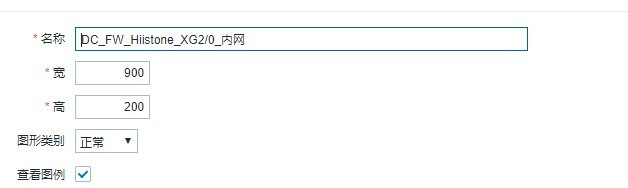

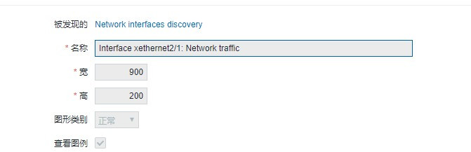

          So where the {#IFDESCR} from? is it from the config in my network device's description part?
          I only want to change the name of graph in zabbix, for example, the config in my switch is 'to building1', I want the graph in zabbix is 'The interface to Building One'.
          So how to change the graphs name?
          This is auto discovery interface, I can not change the name:
          I cloned a graphs, The name can be changed.
          So, Is there any way to modify the autodiscovery interface name?

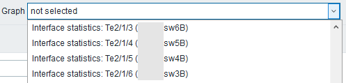

            {#IFDESCR} is populated every hour (or whatever is the configured interval for the interface discovery) to contain the switch interface description fetched with SNMP.
            If you use it in the graph prototype (inside the discovery rule), you can have the interface description included in the graph titles.
            For example, in my interface discovery rule I have a graph prototype named "Interface statistics: {#IFNAME} ({#IFALIAS})", and here are the automatically created graphs in a list:
            The descriptions "xxxxxsw6B" etc. are configured in the actual switch Te2/1/x interfaces, not in Zabbix configurations.
            Markku
